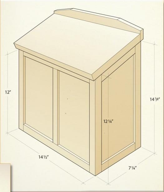

For those of you who are lucky enough to get home mail delivery, a handmade wooden mailbox gives you a chance to show off your woodworking skills to all who come to your front door.
Most wall-mounted mailboxes have lids that cover the entire box open­ing and slope forward. This keeps the rain off the mail and encourages the rain to run off away from the building. Unfortunately, many mailboxes are sized to accommodate little more than #10 envelopes. Whenever any larger object, such as a newspaper or maga­zine, is placed in the mailbox there is a good chance the lid will remain open. No big deal in good weather, but it can be an issue with rain or snow. This mailbox is designed to solve that problem. The typical oversized envelope that shows up in my mailbox is 12″ by 9″. A full size newspaper with its single fold is about 13″ by 12″. It would be nice if these items would fit in the mailbox without the need to further fold them. This suggests an interior space that is at least 13″ by 12″.
Mailboxes reside outdoors. This means that wood movement is a signifi­cant issue that must be addressed in the design. The lid can be made of a single piece of solid wood. Wood movement will not be a problem for the lid since it is not joined to any other part of the box except by hardware. For the rest of the box a simple frame and panel approach should remove any wood movement issues.

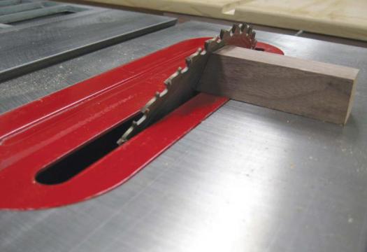

An off-cut from one of the rails makes an effective template for setting the blade angle on the table saw to 70° in order to bevel the tops of the front and back top stiles. Lower the blade to just clear the top of the stiles, set the rip fence so you remove only enough wood to create the bevel and rip the two pieces. A push stick would be a really good idea on this cut. Re-adjust the rip fence setting and raise the blade height a bit to cut the bevel on the back edge of the lid.

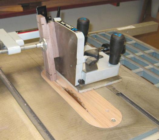

Use a bandsaw to cut the tenons to width. For the small shoulders remove most of the material with the bandsaw. Use a chisel to pare away the waste left by the bandsaw. Use the long shoul­ders created by the table saw to guide the back of the chisel to form an even shoulder all around the tenon.

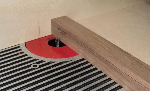

A ¼” straight bit in the router table is used to cut the grooves that the vari­ous panels will mount in. All the slot cuts can be done using the same setup except for the bottom panel grooves in the four rails. Raise the bit to ¼” high and set the fence ¼” back from the bit. I cut the grooves in two passes using a piece of â…›” cleated hardboard to raise the work piece up for the first pass. The hardboard is removed and the piece is run through again for the second pass. When cutting the grooves, run all of the pieces with the outside of the piece against the fence. This will ensure that the grooves are all at the same location, even if the setup is slightly off.
For the stiles and muntins, the groove runs the full length of the piece. Simply rout the piece from one end to the other. For the rails, all the grooves except for the bottom panel groove can be run from one mortise to another. Draw a guide line on the router table fence to show where to lower the piece down over the router bit to begin the cut. You should be able to feel when the bit completes the groove and runs into the mortise space. If you are not feeling comfortable when to end the cut, draw a stop guide line on the router table fence.

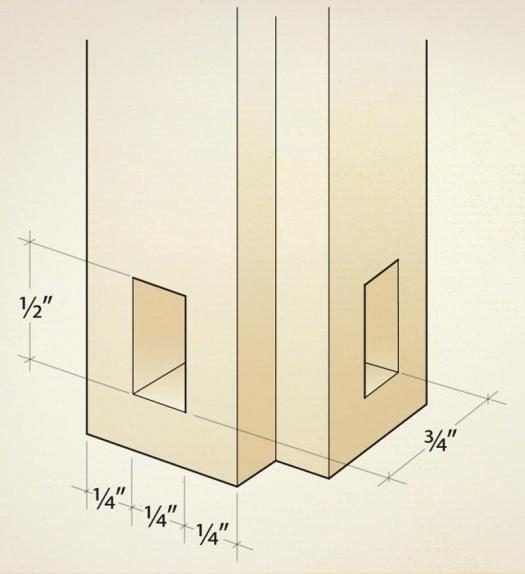

Cutting the bottom panel groove is a bit more complicated. Remember that you have an extra ½” on the bot­tom of the rails. The fence needs to be moved back to ¾” from the bit. Attach an auxiliary fence to the router fence with no bit clearance gap. This will give something for the bottom of the rail to run against for the entire cut. Mark a guide line on the auxiliary fence to show where to stop the cut. Use a large square sacrificial push block to keep the rail square with the fence. For the first half of these grooves you will be able to push the rail into the bit, and stop at the guide line. For the other half you will need to mark a new guide line on the auxiliary fence and lower the rail down on to the bit using the second guide line for positioning and then run the rail over the bit. This second set of cuts will run into the push block as you clear the work piece.

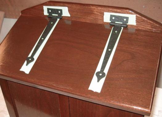

The lid is attached to the crown using some commercially available hinges. The hinges have over-sized holes that the screws pass through. The round head screws have a smooth flat bot­tom that moves easily against the hinge surface. The combination of the over-sized holes and the flat bottom on the screw head allows wood movement in the lid and crown to occur without put­ting undue stress on the screw joints. Without features to compensate for wood movement, stresses on the screws would eventually weaken the wood around the screws and they would come loose.
When laying out the positioning for the hardware on the lid and the crown you will find that temporarily add­ing some masking tape over the finish makes the job much easier. It also pro­tects the finish while you are drilling the pilot holes for the screws.

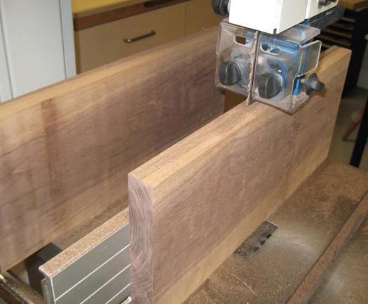

Resawing the panels
 This technique will allow you to produce matched panels for the mailbox.

Setting the table saw
 Using the actual piece to set the angle on the saw blade is the best way to achieve accurate results.

Cutting the angled cheeks
 Using a tenon jig available for your table saw is the easiest way to get accurate results.

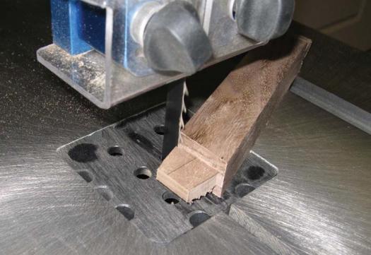

Trimming the waste
 Start with the band saw to trim the tenons and finish off with some paring cuts with a sharp chisel.

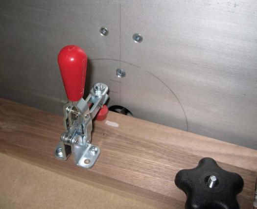

Cutting the long slots
 Use guide lines on the fence to establish where to start and stop the cut.

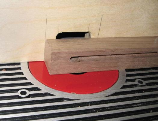

Cutting the bottom panel slots
 Use a backing board to push the work through the bit to ensure the grain doesn’t blow out the back.
Laying out the hardware
 Some masking tape will help protect the finish while laying out the screw locations.
