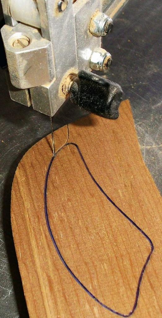

Approach 'inside fitting' one piece at a time. First, cut outside piece.
Then, so that pieces fit inside one another, hold outside piece onto selected wood, and trace inside piece.
Cut on the lines
Hold pieces together, then cut between them

Cut Out the Pieces
This is a crucial step, and the more careful and patient you are, the better your project will fit together. The blade you choose depends to a large extent on your scroll sawing experience. A #5 or #7 DT/R (double-tooth/rev) blade is a good choice for beginners. With it you can make clean, precise cuts. A #5 or #7 P/S (precision skip) blade will cut faster and require more attention. The fastest cutting blade is one with a hook/tooth design. With this blade you can cut ¾” cedar with a #3 or even a #1 blade if you are careful. It leaves a smaller kerf and gives a better fit. But it is easy to over-cut because they are so aggressive.
Cut on the lines. A good method to get a piece to fit inside another piece is to trace one piece over another. Make sure the blade is square to the table. Take your time and cut on the line. When you have the pieces cut out, dry assemble and check the fit. The rest of the pieces can be fitted by which ever method you like. I have had good success holding pieces together and cutting between them.
A spindle sander helps to get pieces to fit snugly together. The fit should be reasonably tight, with no gap larger than a saw kerf. Use a business card as a gauge.
