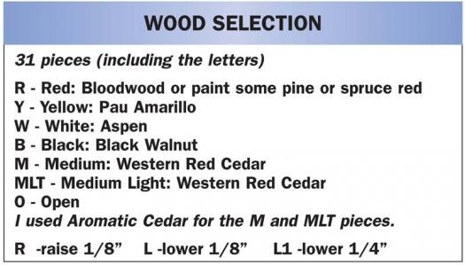

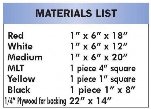

Select The Wood
Use the woods suggested. The flag has got to be red and white, and the suggested woods will do just that.

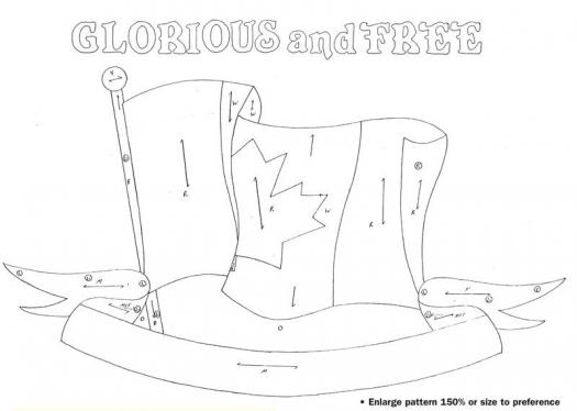

Transfer The Pattern
Transfer the pattern to the wood with whichever method you find best:
– trace onto the paper
– make template of pattern and trace on
– photocopy and cut and paste

Raising, Lowering and Shaping
Only one piece is raised 1/8”. The other pieces are lowered in the shaping process. The drawing in fig.1 is of side profiles that may help show how the pieces are shaped. The pieces should flow into each other as a flag would.
Note
The dotted line pointing toward the L suggests shaping down to that level (see pattern). Following that dotted line will help with the shaping.
