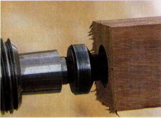

Drill center (smaller than hole) with saw tooth bit

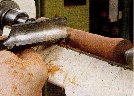

Shape with roughing out gouge

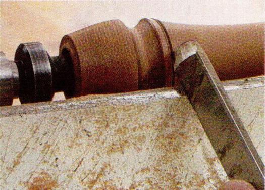

Use skew to roll bead
Use skew to make V-cut

  • Drill the hole (to mount the bristles) before you begin turning, because if you shape your piece to a finished diameter first, and then try to drill a hole in the end, chances are the piece will split.
  • To drill the hole, I used a ¾” saw tooth bit in a drill press. It could also be done on the lathe by holding the wood in a chuck, and drilling from the tailstock end with a Jacobs’s chuck. I also use a smaller center than the hole. That is so I can cut right to the end, without hitting the center. If you don’t have a smaller center, just flip the wood with the hole onto the cone of the live center, with the drive center in the other end. The only disadvantage of this is that you will loose some wood at both ends.
  • Cut the corners off. There is a fair bit of resistance at this point, so I present very little metal from the gouge to the wood. For this cut I presented the gouge with the flute in an upward position. With the corners cut off, there is less resistance. I can also present more metal to the wood to obtain a smoother cut.

  • You can do much of the initial shaping with a 1-1/4″ roughing out gouge, layed on its side, to give more of a shearing effect. In fact, as long as you can get the gouge into the shape you want, it can be used for initial rough turning of the shape. It is also effective for fine finishing cuts. When done properly, a fine turning cut (such as shaping a ball on the end of a piece), usually requires very little sanding.
  • I use the heel (or short end) of the skew to shape or roll the bead. I use the same tool to make the V-cut. The V-cut is just repeating an end cut, on left and right sides. You can do a small V-cut, or repeat the cut over and over to obtain a fairly large V-cut.
