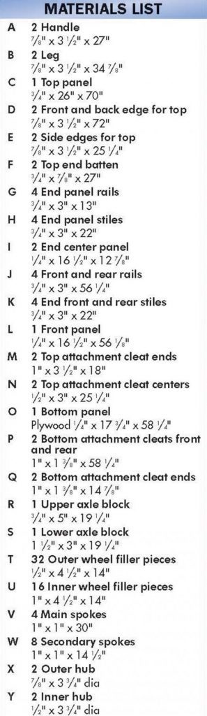

The material for the entire cart is milled from 5/4 (1 ¼”) cedar decking that I purchased at my local building supply centre. If you can’t find 5/4 stock you can use standard width (¾”) material, but you will have to make adjustments to the dimensions.

• The body is made of three frame and panel sections and one face frame section. The center panels must be stained before assembling the frame around them.
• Mill enough ¼” stock to glue up three panels.
• Glue up, sand, and finish the three panels.
• Mill the stock for the four frames to ¾” thick.
• Using a table mounted router and a matched set of tongue and groove cutters, cut the tongues and grooves needed to assemble the outer frames.
• Assemble the two end panels and set them aside.
• The front and rear panels require an additional dado to be cut the full length of each piece ¾” in from the outer edge. Cut these now. Then assemble the front panel and the rear face frame.
• Sand and finish the three panels and the face frame.
• The end panels fit into dadoes at the ends of the large panels. Glue and clamp these together, measuring the diagonals to ensure the assembly is square.
• Cut the ledger strips for the bottom, and glue these into place, using clamps.
• Cut a ¼” thick piece of plywood for the bottom, and when the glue has set on the ledger strips, glue this in place from the inside. Screws or ¼” crown staples will hold this in place until the glue has set.
• The two outer top attachment cleats are set inside and flush with the top edge of the main carcass. Glue these to the edge and use 2 ½” countersunk screws along the front and back edge to hold this in place.
• The center three top attachment cleats are recessed into mortises in the front and back. These can be cut easily with a router.
Top
• The top is a ¾” thick panel glued up from the 5/4 stock. A frame around this panel provides a lip that keeps things from rolling off the edge.
• Mill all of the material for the top to ¾” thick.
• Glue up the center panel.
• Flatten and sand the center panel.
• Apply two or three coats of finish to the panel and set it aside.
• Cut the material for the outer frame members.
• Run a ¾” dado the full length on the back face of each board.
• Attach the two front and back sections to the sides of the top using glue and seven countersunk brass screws.
• Cut the ends to fit in between, and fasten them in place in the same manner.
• Cut the stock for the end battens; notch each end to fit and radius the outer corner.
• Drill a countersunk hole 4″ in from each end and attach to the top with brass screws.
Handles and Legs
• Mill the material for the arms and legs to ⅞” thick.
• Cut the legs and handles to length.
• Cut the half-lap joint where the handle meets the leg.
• Glue, clamp, and screw these pieces to the legs and side handles. Sand and finish these prior to installation.
