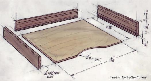

Cut Bottoms
First, decide how many trays you need, I chose eight. Then, from 1/8″ plywood, cut the bottoms to 11 ⅝” x 8 ¾”. Mark an arch on one. Stack the bottoms, with the one you just marked on top, and tape them together. Stack saw them with your band saw.
Cut Slot for Bottom
Raise your table saw blade 3/16″ high, and set your fence ¼” from the blade. Cut all your stock with the groove against the fence and the good face facing up. Check to see that the bottom fits in the slot. It should slide in easily but not fall out. If the fit is too tight, run a piece of scrap through as a test piece.
Move the fence slightly away from the blade and make another cut on the test piece. Repeat this until you get a proper fit. Then, run all you pieces through again.
Cut Parts to Size
Cut two sides at 8 15/16″ and one back at 11 ¼” for each tray. Remove the tongue and groove from each of the back pieces. Sand everything before assembly.
