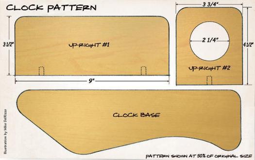

It’s a good idea to purchase your clock insert before you begin your project. I used a 2-3/4″ clock insert that fits in a 2-1/4″ hole. You can choose a different clock, but make sure you have the appropriate sized bit to cut the clock hole.
- Cut the base from a piece of 3/4″ MDF. You can also use plywood, particle board, or solid wood. Tilt your scroll saw table 25° to the left, then cut out the edge of the base in a clock-wise direction.
- Prepare two upright pieces from the same stock you used for the base, cutting the edges at a 90° angle.
- Round over the edges on the top and sides with a router. If you don’t have a router, hand sand the edges.
- On the smaller upright piece, drill a 2-1/4″ hole for your clock insert. A saw tooth bit cuts a cleaner hole than a hole saw.
- On the bottom of both upright pieces drill 1/4″ holes that you will use to join the uprights to the base. Drill corresponding holes in the base, making sure you don’t drill all the way through the base. You can line up the hole locations by eye, or you can use a set of dowel centers, which greatly simplify the task.
