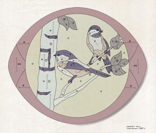

Most intarsia projects start with ¾” material, but for these little guys, I used ⅜” stock for the bird in the back and the tree, and ½” stock for the bird in the front. The finished project measures 14″ x 11 ½”, and consists of 59 pieces.

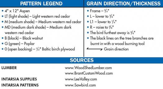

• Careful consideration of the colour, texture and pattern of the wood you use in intarsia is important. Most of the colours in this project are straightforward, but shades can vary to some degree. The light, medium or dark shades specified in this project should vary in relation to each other.

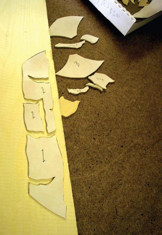

• For the template method use spray glue to attach the template onto some thin material such as ⅛” MDF. Use the template pieces to trace onto the wood.
• Cut out all the pieces with a thin blade, such as a #0 or #2/0.
• The smaller the kerf the tighter the fit you will get.
• You can also photocopy the pattern, in which case you will need five or six copies.
• Cut the pieces off the pattern and spray glue them onto the wood.
