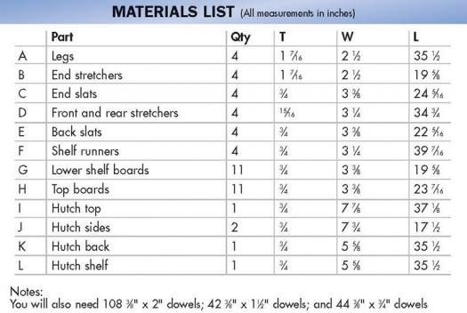

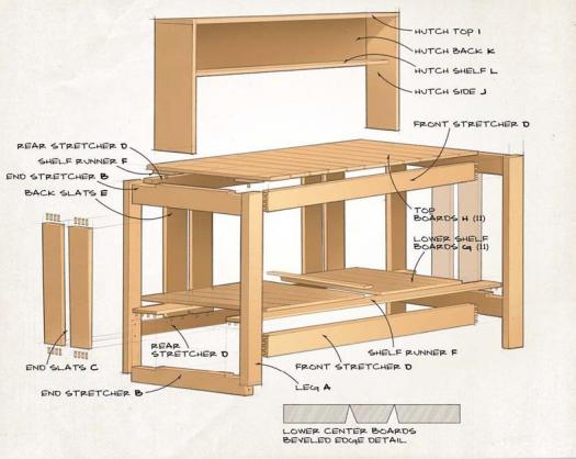

Build End Frames
• Begin by milling the lumber for the legs (A) and end stretchers (B) and cutting the pieces to length. Select and mark the best faces for the front side.
• Mill the stock for the end slats (C) and use a stop block to cut the four pieces to exactly the same length.
• With all of the parts for the ends cut, lay them out with the best faces forward as they will be assembled. The bottom of the lower stretcher is 6 ¼” up from the bottom of the leg. Use a square to draw a reference line across the two inner faces of the legs. These lines, as well as the underside of the bottom stretcher, are one of the two required reference faces for this joint. The inner side of the leg and the inside face of the stretchers are the other.
• Lay out and drill holes for two dowels at each joint. Repeat this for the top stretcher. Again, the inside faces of the leg and stretchers are one reference face, but this time the other reference face is the top of the leg and the top side of the stretcher.
• Chamfer the four long sides and bottom of the legs with a 45º bit on a router table. Chamfering the bottom prevents chunks from tearing out of the legs as the bench is moved. Also chamfer the long edges of the end stretchers.
• Use a band saw to cut a ¾” x 3 ¼” long notch out of the top ends of each end stretcher to receive the shelf runners (F).

• Mill the front and back stretchers (D) and cut them to length. Use a stop block – they must all be exactly the same length.
• Mill the four pieces for the back slats (E), also using a stop block to cut them to length.

• The two decks (ie. the upper work surface and lower storage shelf) are where this project either comes together or falls apart. The upper deck is glued together forming a rigid platform with gaps between each board. The lower shelf is made of loose boards laid edge-to-edge to form a solid surface that things won’t fall through. With so many boards laid side-by-side, there is the potential for considerable seasonal expansion. Failing to allow for an expansion joint would force the bottom shelf to act as a ram and pry the joints with the ends apart. On the rigid upper deck, there is space between each board for expansion and the two dowels in each end are oriented along the length to prevent the board from splitting.
• Mill the material for the four shelf runners (F) and cut them to length.
• Mill the material for the lower shelf boards (G) and cut them to length.
• Mill the material for the top boards (H) and cut them to length.
• For the following stages you will have to begin assembling the potting bench. Assemble the sides, back panel, and front stretchers. Take two of the shelf runners and set them into the notches in the lower side stretchers. Use a couple of band clamps around the legs to keep the whole assembly drawn tight, or you will be unable to accurately locate the dowel holes for the runners.
• Set the upper shelf runners into the notches in the upper stretcher. The runners should run to the edge of the chamfer on each leg. Use some form of a clamping jig to ensure the bench is standing square. I used a 12″ melamine square with some 2 ½” clamp holes drilled into it.
• The slats for the upper deck will overhang the front, back and sides by ½” with a ¼” space between each slat. To be sure that everything aligns, it is important to establish the same reference edge for all of the dowel holes. Place one of the top boards in place and establish the proper overhang on the front and back. Transfer the location of the front edge of the two.
• Find the center of the shelf runner end to end. Working out from there, use a square to draw lines out in either direction on 3 ¾” centers. This represents the centerline of the two dowels in the runners. They are simply centered on the individual boards.
• Drill these holes to a depth of just slightly more than â…œ”. In all likelihood you will not find any â…œ” x ¾” dowels so simply cut some 1 ½” dowels in half.
• Test fit the top boards to the runners.

• Set the boards for the lower shelf in place. They will be too wide for the space available so leave the last one out and a gap in the middle.
• Use a table saw or jointer to slightly bevel the edges of the two boards facing each other over the gap; 10º should be more than enough.
• Bevel one edge of the remaining board originally left out. Use the table saw set at an angle to rip the piece to width to fit in the gap, then drop it in place. With the edges on either side of the narrow center strip bevelled, any seasonal expansion will cause the center strip to buckle upward and pop out, preventing the leg to front and rear stretcher joint from being forced open.

• To create a little extra storage space for seeds, tools and pots, or condiments and other accoutrements next to the BBQ, add a simple hutch to the top. If you can find some wide stock then make each piece from a single board. If wide stock is not readily available in your area, glue up some narrower stock using type 2 wood glue, such as Titebond III.
• Mill the material for the five hutch components (I, J, K, L) and cut them to length.
• Lay out and drill dowel holes to join the shelf to the back. Assemble these two pieces without glue for the next step.
• Lay the sides on a table and place the assembled shelf and back in place between them. Line up the top edge of the back and the top edge of the sides. Mark the underside of the shelf on either side. Measure back â…œ” to locate the centerline of the dowels. Drill the holes in the ends of the shelf, back and in the sides.
• Lay out and drill the dowel holes for the top and dry fit everything.
• Disassemble the pieces and chamfer the visible edges on the router table, sand and finish each piece.
• Glue the hutch together and clamp it. Check the diagonals for square.

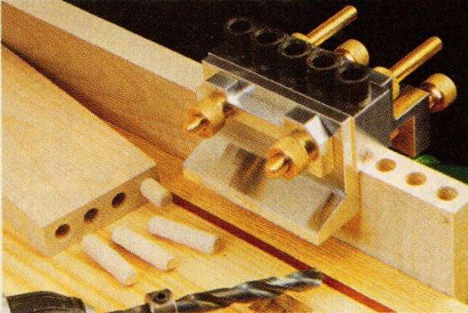

To make dowels work in a project you have to be able to easily and accurately drill holes precisely where you need them. Over the years I’ve built plenty of dowel jigs for various situations, investing considerable time I would rather have spent working on my projects.
I recently picked up a DowelMax at the Victoria wood show, after watching a demonstration by it’s designer, Jim Lindsay. The heart of the jig is a precisely machined aluminium guide block with 5 hardened drill guides for either â…œ” or ¼” dowels. Using a combination of the fence, angle bracket and the clamp bracket with the guide block it is easy to locate the jig anywhere on the work piece. By always using the same two reference faces, drilling perfectly matched holes in facing pieces that match up every time is child’s play.
A guide rod allows perfect spacing of holes on longer surfaces while drop in spacers center the jig on stock of different thicknesses. The bit included with the kit drills a perfectly sized hole for Laurier dowels.
A tool is only worth investing in if the return is worth it; it has to be cost effective, and with DowelMax commanding a premium price it has a lot to live up to. It’s easy to assume that a tool like this is made by a huge company and that the price is unreasonably high. Consider that in this day of most tools being made in China, Dowelmax is a small family run business based in
North Vancouver. There are over thirty components in the complete system, that are all made at three local independent machine shops out of the highest quality materials providing employment for several skilled craftsmen.
So does the DowelMax live up to the promise, and is it cost effective? In a word, absolutely. All 384 dowel holes in this project lined up as if they had been drilled using a CNC machine. Given the precision and ease of use of the DowelMax I plan on using it for a lot more projects.
