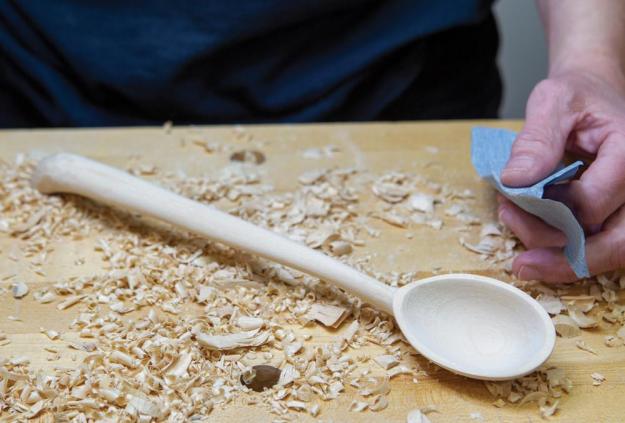

The spoon now has its basic shape but is likely still very textured. The next step can be accomplished using just sandpaper or you can use fine rasps, files or scrapers to get the look and feel you desire. You can use a rasp or file on both the handle and the back and use a scraper to clean up the bowl. I use sandpaper for the final touch­ups, starting with 120x, then 180x, and finally 220x on the parts I want smooth. The inside of the bowl is usually the biggest chal­lenge to clean up.

Sand it Smooth
Though there’s nothing wrong with leaving small, flat facets made by the hand tools you used to carve a surface, there’s also nothing wrong with removing all of those facets with sandpaper.
A Flat Rim
Laying a piece of sandpaper on a flat surface and sanding the rim of the bowl will leave you with an even, flat rim.
