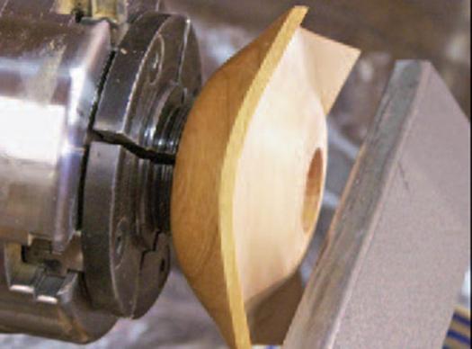

• Start to cut away the corners and curve the sides, cutting from the center out to the edges. This becomes an interrupted cut as you progress up the side and out to the edges, so you need to maintain control of your gouge. You need to decide the line of your cut and follow it regardless of whether there is wood in front of the gouge or not.
• On a blank this size you will get a clean cut at about 1500 rpm. At this speed the “shadow” outline of the corners is very faint – stop the lathe often to check your progress.
• Aim for a gentle S-curve from the base to the corners, leaving the corners about ¼” thick.

• Sand the top face of the candle holder using a 2″ disk and electric drill. Keep the face of the sanding disk angled a bit so that it doesn’t catch on the corners. This usually will cause the leading edge of the corners to become slightly rounded over. After you finish sanding you can flatten these edges (and remove any small chip outs) with a block plane. Use a piece of 400 grit paper to ease the ‘sharpness’ on the top edge and corners.

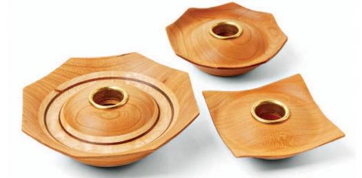

All that is left now is to turn its mate, because candle holders always come in pairs.
Variation On A Theme
Rather than using a square piece of stock you can cut the corners off the blank before mounting it, so that it is an octagon. This is actually easier to turn and might be a good way to start if you’ve never turned a square piece before. The corners on an octagon are much closer together so you are not ‘turning air’ nearly as much. You can use a mitre saw set at 45° to cut the corners. Since I am not fond of getting my fingers too close to a spinning blade I make the blanks for octagonal holders at least 4″ square. As well, a smaller blank would not give as distinct a ‘scalloped’ effect to the edges.
