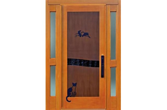

The mandate here was for a door that was simple, yet elegant and majestic. It would also include some of my customer’s hallmark symbols, namely the household cat, a pair of ravens and the nearby ocean.

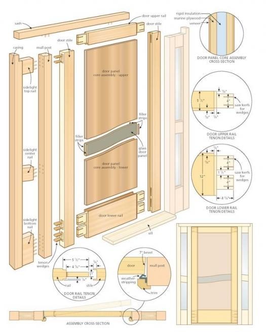

Only when the artistic design is complete is it time to think about how the door will be crafted. For this stage, Sketchup is a great option. Each piece of lumber, as well as each joint, is simulated with this CAD tool. This not only helps create a detailed list of materials needed, but it also forces one to think about the critical construction details.
One example of these details is how the door will be glued together. Even though the technicalities have been sorted out at the CAD level, I chose to adapt some of the exact dimensions to accommodate each of the pieces of wood that was carefully selected. The final creation will be dictated by the character of the wood, and not by a three-dimensional design on the computer screen.

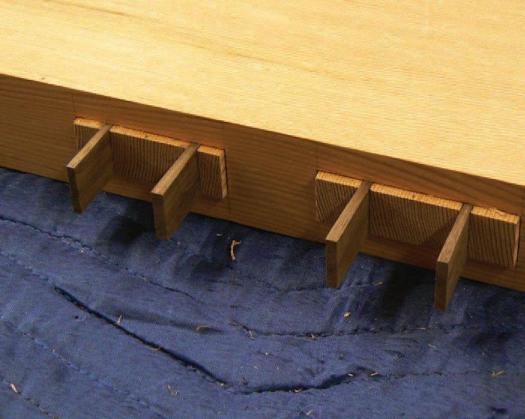

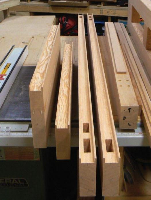

For this door I favoured visible joinery; a traditional through-wedged mortise and tenon joint. Once assembled, the tenon will show through the stile. It’s a bit harder to make than a regular mortise and tenon, but it results in a very strong and beautiful joint. After breaking out the four frame members I cut the mortises with my mortising machine, then cut mating tenons on the rails.
The door panels are made of a 3/4″ rigid insulation core with marine quality plywood glued onto each side. I used LePage’s PL300 foamboard adhesive for this. On top of the plywood is 1/8″ thick fir veneer, which is fixed in place with epoxy. This makes for solid, stable and light construction. The finished thickness of the panels I made was 2″, for a number of specific reasons, but I would recommend making your panels’ finish about 1-1/2″ to 1-3/4″ thick so the groove in the door frame can be narrower. This results in thicker and stronger groove sides in the doorframe.

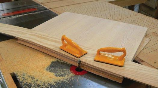

I break out the plywood panels about 1″ over finished size in width and length. I then glued the outer plywood skins to the rigid insulation in my vacuum press. When the adhesive was dry, I cut the panels to finished size. I needed to be exacting with my tolerances at this stage. The panels fit in the grooves in the door stiles and rails, butting right up against the inner surface of the groove in the rails and stiles, where adhesive helped to lock the panels in place. I then used a router and trim bit to shape the panel’s curved edge. I could now apply the outer 1/8″ veneer to the panels in my vacuum bag and flush trim them.
The curved glass piece will fit into the groove in the stiles, as well as into a groove that needs to be machined into the curved ends of the panels. I used a router with a three-wing slotting cutter for this. This piece could also be made of wood if you wished.

Once the door is glued together, the wedges were inserted into the tenons. When the glue was dry, I machined a groove for the door sweep with my router, straight bit and edge guide. I also sourced the sweep from Draft Seal. I used their

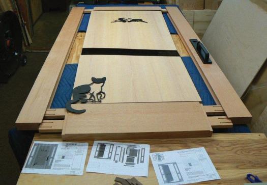

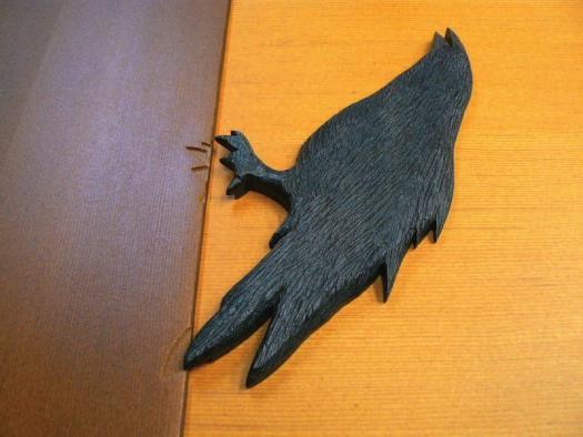

Once the door is glued together, it’s time to work on the artistic additions. The outside boasts a pair of ravens made of metal (cut by a plasma cutter), taunting the household cat (also made in metal) from the branches above.
For ease of future clean-up I simply screwed these figures onto the door panels. To ensure the cat is properly level with the door panel I routed the tail into the bottom door rail – practical, yet also aesthetically pleasing.

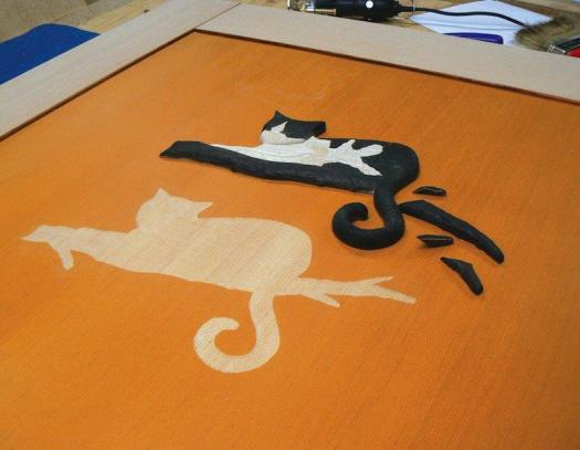

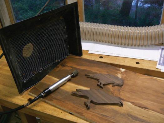

On the inside of the door, the tables are turned; the cat rules the roost as the ravens conspire below. These pieces are cut out of walnut and eastern maple. The cat is made as an intarsia; that is, composed of different pieces of wood. I cut these pieces on a scroll saw and then sand them accordingly. Then an appropriate texture is also carved onto each of the pieces. The ravens are made of one piece, carved for fitting texture and then stained dark.
The precise shape of each of these creatures is meticulously routed into the door panels so each one is shallowly inserted about 1/8″ deep. This ensures no glue spill-over will happen and provides a tight fit.

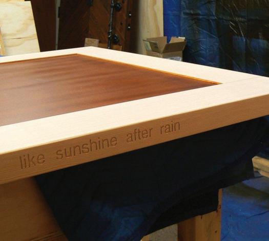

A personal quote is also carved into the outer door stile. The next critical part is finishing the rest of the door. After making the mortises for the door hinges, entry set and automatic door sweep, the piece was ready for a final sanding. I sanded all parts of the entry down to 220 grit, then covered the panels and prepared the door sidelights. An added challenge with this design was that each door side had a different stain. To address this challenge, I covered one door side while spraying the other. I used Bomol Cedar as a topcoat, but there are many good finishes available.

Any fine craftsman wants to avoid excessive fine-tuning on site. For this reason, I fully assembled the door and the sidelights in my workshop first, testing for the proper operation of all parts. For example, I made sure the door was the same distance from each of the jambs/sidelights, and that the door opened smoothly and closed perfectly on the encompassing weather-stripping.

The long-awaited moment has arrived. Installation complete, it’s time to step back and admire this unique door from inside and out.

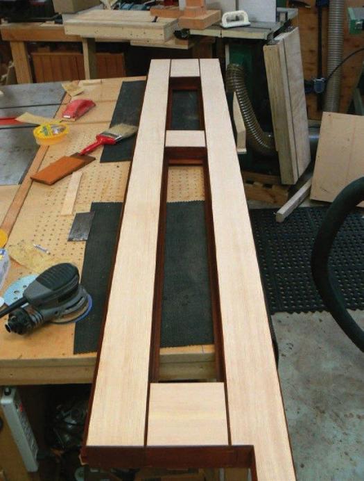

Sidelights
 After making the sidelights, Rodeck finishes them. Here they are only partially finished, as the final interior and exterior colours are different.
Door Joinery
The rails are joined to the stiles with through mortise and tenons. The final joint is very strong, and is pleasing to the eye. In this photo, the tenons are not machined on the ends of the rails yet.
Plywood Template
 A curved template assists in laying out and cutting the curve on the panels of the door and curved rails of the sidelights. The template can be temporarily fastened to the parts with double-sided tape, then a rout and flush trim bit can be used to trim the workpieces.

Natural Details
To bring some of the natural world into this door, Rodeck cuts and shapes two ravens out of wood (above), then adds them to the door (below).
A Watchful Cat
To add a playful element, an intarsia cat is added to the interior side of the door, above the ravens. Rodeck routes a 1/8" deep cavity into the door’s surface and glues the cat into it. On the exterior side of the door, the opposite is the case; the cat is down on the ground, while the birds watch from up in a tree.
Nice and Strong
Once the door is assembled, Rodeck glues contrasting wedges into the slots in the tenons. This helps lock the joint in place and creates a nice-looking detail. Once dry, the joint can be trimmed flush.
A Quote
 A personal quote was added to the outside of the door’s stile before the finish was applied.
