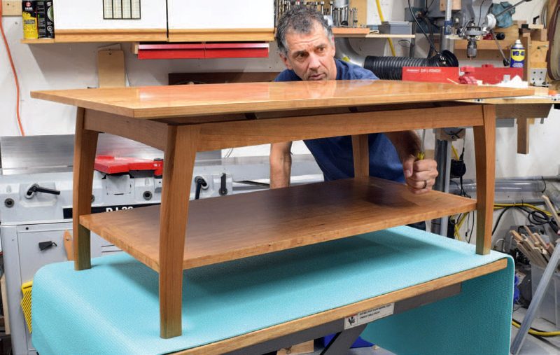

This refined-looking coffee table would work well in a formal living room or a cozy family room. It features curved, tapered legs and a top that floats above the base.

Curve the legs
Machine the leg stock to 1-1/2″ thick and about an inch longer than needed. Rough cut the approximate outside and inside curves leaving them oversize by about 1/4″. If possible, use rift sawn stock and orient it so the grain follows the gentle curve in the leg. Clamp the leg to the outside curve template and rout the leg flush with a pattern routing bit. Depending on the cutting height of your bit, you may need to make two passes to flush trim the entire thickness of the leg.
To ensure alignment between the inside and outside curves, the leg needs to be cut to length before you machine the inside curve. Do this with two cuts using a sled at your table saw with the tem­plate that orients the leg at the finished angle. The template ensures that both ends of the leg are parallel. Return to your router table to flush trim the inside edge of each leg using the two-sided template.
Plunge router mortises
There are several ways to connect the rails to the legs. I chose to use slip tenons and used my router to cut the mortises. You could also use dowels or Dominos. It is best to cut the joinery before you do any further shaping of the legs.
The long rails mate with a mortise into the flat portion of the inside of the leg. This is machined with a simple mortising jig that has a slot for a guide bushing. Underneath, a fence positions the leg so the mortise is off­set the correct distance from the outside face. Additionally, a stop block screwed to the fence correctly sets the leg angle and posi­tions the mortise relative to the top of the leg. Clamp the outside face of the leg to the fence with the top of the leg flush with the stop block and rout the mortise in two of the legs. Relocate the stop block to the opposite end of the slot and rout the other two legs. Each pair of legs should be mirror images.
Use the same jig to rout the mortises on the inside face of each leg for the short rails. These mortises are angled relative to the top of the leg so the rail will appear parallel to the outside curve of the leg. Rather than using an angled fence, you can leave the fence parallel to the slot and adjust the position so the mor­tise is in the correct location when the outside of the leg is against the fence. The shallow curve of the leg makes it easy to position it approximately parallel to the straight fence at the location of the mortise.
If you’re including a shelf with your table, there is one more mor­tise to rout in each leg. This one is parallel to the bottom and top of each leg. If you use the same mortising jig, be sure to limit the travel of the router since this mortise is only 3/4″ long.
Shape the legs
With the leg joinery complete, you can now round over the out­side of the leg. The radius of the round over is not critical, provided it doesn’t interfere with the joinery. I used my shaper with a 50 mm radius cutter for this operation; a large round over bit in your router table will work just as well or you can even use a block plane to cre­ate the profile.
To lighten the look of the legs, the opposite sides are tapered so the leg is 1″ thick at the bottom. The taper starts 2″ down from the top of the leg on the side with the short rail joint; the opposite side doesn’t have any joinery so the taper can start at the top. I cut the taper at my table saw using a sled with stop blocks and toggle clamps to securely hold the leg in place. A bandsaw with a freehand cut would also work, as would a tapering jig for your thickness planer. Whichever method you use, clean up any saw marks with a hand plane.
After tapering, the top of the leg will appear to have more round over than the bottom. To make the round over look continuous, I used my block plane, a scraper and sandpaper to refine the shape.
Machine the rails
Machine the rails to the finished thickness and width and cut them to length, leaving everything square for now. Rout a mortise in the end of each rail using the same mortising jig. Use a 1/8″ shim between the fence and the outside face of the rail so the mor­tises are in the correct position. The top of the rail should be tight to the stop block screwed to the fence.
If you have not already done so, now is a good time to machine the slip tenons. I made mine from maple and used a 1/8″ radius round over bit on the edges to match the 1/4″ mortising bit. The tenons should fit snuggly in the mortises but not so tight that you need a hammer to insert them. When cutting the tenons to length, leave a bit of room for glue at the bottom of each mortise.
The ends of the long rails need to be cut at an angle to match where they join the legs. Do this after you machine the mortises. If needed, fine tune the angle on the long rails for a perfect fit with the leg.
The top of both short rails need to be bevelled to be flush with the top of the legs. Dry fit a rail with the legs and mark the bevel angle on the end of the rail. Set your jointer fence or your table saw blade to this angle and cut the bevel.
The underside of each rail has a shallow curve which is easily cut with the bandsaw and cleaned up with a spokeshave, scraper and sandpaper. You can tilt the bandsaw table to match the bevel angle when cutting the curve on the short rails, as this will keep the two edges parallel, but to be honest, this detail will be missed by just about everyone.
The final step for the long rails is to rout three stopped dovetails for the cross braces that support the top. The specific dovetail bit isn’t critical provided the widest part of the bit is less than 3/4″ (the width of the braces) and that it can cut 3/8″ deep.
Glue the long rails
There are too many parts to try to glue up the table all at once. Instead, I start by gluing the long rails to the legs. Do a dry fit in case you need to trim the slip tenons. Ensure the top edge of the rail is flush with the top of the leg. Use a pair of angled clamping blocks to keep the clamps from slipping on the curved legs. You shouldn’t need a lot of open time, so PVA glue will work fine for this step.
Add the shelf
The shelf is constructed with breadboard ends mortised into the side of the legs. This is done so the main part of the shelf can expand and contract in width with the seasons, independently of the length of the breadboard ends. Dry fit the short rails to the glued long rail and leg assemblies so you can transfer the exact angle and length of the breadboard ends. Cut the ends to length, machine the mortises and use slip tenons to dry fit them between the legs. With the ends in place, you can measure the width and length of the shelf and cut it to size. Also measure the angle of the outside of the leg at the height of the shelf so you can machine a matching bevel on the front edge of the breadboard ends.
Use your preferred method to join the breadboard ends to the shelf. If you use the simple mortising jig, I recommend machining five equally spaced mortises across the ends of the shelf. The matching mortises in the breadboard ends should be about 1/4″ wider except the one in the middle, which can be a tight fit. The slip tenons should be glued into the shelf, but only the middle one should be glued into the breadboard end. The remaining tenons should be allowed to float to allow for sea­sonal changes in the shelf width.
Make the top and the supporting cross braces
I recommend using your widest boards to make the top so it has the fewest joints. Arrange the boards so the colour and grain look continuous. If desired, you can use Dominos, biscuits or dowels to help with the alignment during glue-up. Once glued together, bevel the underside of the top so it appears thinner. I used a mark­ing gauge to scribe a 2″ wide bevel that left about 1/2″ of material at the edge. I got a workout removing this wood with my hand plane; it would have been much faster to use my table saw with a tall fence and an angled blade.
The top floats above the base on three cross braces that are fastened between the long rails with sliding dovetails. Set up your router table with the same dovetail bit that was used to rout the sockets in the long rails and set the height to match the depth of the sockets. Dial in the fence posi­tion using a scrap the same thickness as the cross braces. When you have a secure fit, do the same operation on the cross rails.
Cut away part of the bottom of the dovetail so the cross brace sits 3/4″ above the top of the rails. Add curves on the upper, outer corners of each cross brace. This curve further exaggerates the floating top look. The curve can be bandsawn then either sanded or pattern routed to its final shape. Next, drill screw holes and counterbores that will be used to fasten the top. The outside holes should be elongated to allow the top to move seasonally.
Glue the rest of the table
I chose to pre-finish the table before I glued it together so I didn’t have to worry about glue squeeze-out. I padded on a dark shellac to highlight the rich colour of the cherry and followed up by spray­ing on several coats of polyurethane. Once the finish dries, you can glue together the base with the shelf and the short rails. I did sev­eral test runs to pre-set the clamps, check that the short rails were flush with the top of the legs and to make sure each joint closed tightly without any gaps.
Once I was satisfied, I was ready to start gluing. You could use PVA glue, but I mixed up some five-minute epoxy to give me more open time to align all the pieces without having to struggle. Once the adhesive hardens, glue the cross braces into the dovetail sockets in the long rails. I used PVA glue for this step. Finally, drive screws into the cross braces to secure the top.
