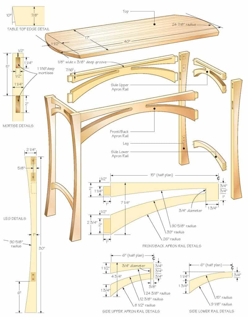

Face aprons are cut from single boards and opened with sweeping curves to create a light and graceful look. The face frames are braced with two aprons: the upper being a scaled version of the face and a lower higher single arch. The legs are also curved outward along their length mirroring the upper curve of the face apron. The top is shaped with parallel sides and curved ends, all cut at an angle to blend into the leg curves.
The frame is built with pinned blind mortise-and-tenon and dowel joinery for strength and clean, uninterrupted lines. Sliding brackets attach the solid top to the frame to allow for seasonal movement. The table measures 31″ H x 40″ L x 17″ W and is finished in low-lustre Tung oil with a Varathane finish.

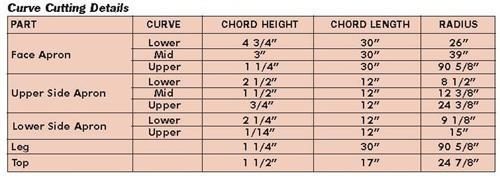

Cut the templates for the legs and the three apron shapes, full-size. Using the curve details on the drawings, trace the leg and the three apron shapes onto MDF or hardboard. The radius of each curve is given so that you can draw the curves with a beam compass.
Cut the curve of the leg template just to the waste side of the line. Do the same for the upper and lower curves of the lower side apron. For the face and upper side aprons, drill out the end of the main cut-out with a ¾” Forstner bit in a drill press. Bandsaw from each end to this hole to complete the cut-outs and then saw the main continuous lower curve. Use your preferred combination of spoke-shave, drum sander and/or wood file to clean up the saw marks and smooth the curves to shape.
TIP: To reduce drawing and template making time, the leg curve is the same as the upper curve of the face apron.

Use blind mortise and tenon joints to connect the apron to the legs. Cut the legs to width and form the face apron mortises (see detail) using your favourite method. The mortises are ½” wide, 1 1/16″ deep and centered on the width of the leg. The upper mortise starts ½” from the top and is 1 ¼” long. The lower starts 5″ from the bottom and is 2″ long. Clean up with a sharp chisel and lightly relieve the edges of the mortise to prevent splintering.

Use the leg template to trace the curve of the leg. Use carpet tape to stick two leg blanks together. Align the mortises and cut out on the bandsaw. Use more carpet-tape to stick each pair of legs together and sand all four to shape. While they are stuck together, joint the long straight edge and cut the bottom of the legs to length. Separate them and mark back/front, left and right on the top end grain.

As the top is made of solid wood, it will expand and contract with seasonal changes in moisture. To allow for this movement and yet firmly attach the top to the frame, metal “Z” brackets are used. One end of the bracket screws to the underside of the top while the other end grips a groove cut around the apron. A groove is cut into the inside top of all apron rails. It runs through the side upper apron but is stopped before the tenons on the face aprons. Use the table saw to cut a ⅛” wide groove ⅜” deep and 7/16″ from the top. If you are using different hardware, adjust these measurements appropriately.

Dowels are used to attach the side upper and lower aprons to the legs. The dowels at the top of the side apron pin the face apron mortise and tenon. In each leg, drill the four ¼” dowel holes ¾” deep (see details).
Starting with the front frame, use dowel centres to transfer the hole locations to each apron in turn. Ensure that the top of the apron is flush with the top of the frame and position it ¼” from the straight edge of the leg. Drill the two dowel holes in each upper apron ¾” deep using a brad-point bit and stop. Position the lower apron 6″ from the bottom of the leg and centre it. Mark the holes as before and drill ¾” deep holes. Use 1 ¼” long, ¼” wide fluted dowels and test fit all joints. Do the same with the back frame for the upper side aprons.

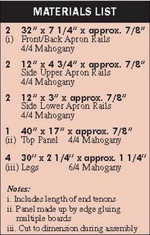

Laminate The Top
Choose the mahogany boards for the top with the best grain pattern, colour, and match. Joint each edge and plane for consistent thickness. Cross cut each board approx. 1″ longer than necessary and wipe on a coat of Tung oil to the faces of each board – this will help in cleaning up any glue squeeze-out. Apply a thin even layer of glue to each edge, working it into the wood a little.
Clamp the boards alternatively top and bottom and apply sufficient clamping pressure to raise a small bead of glue from the joint. Check for flatness and if necessary, clamp across the joint ends of two boards to align them. When dry, scrape off any glue and sand or scrape the top until it is flat.
