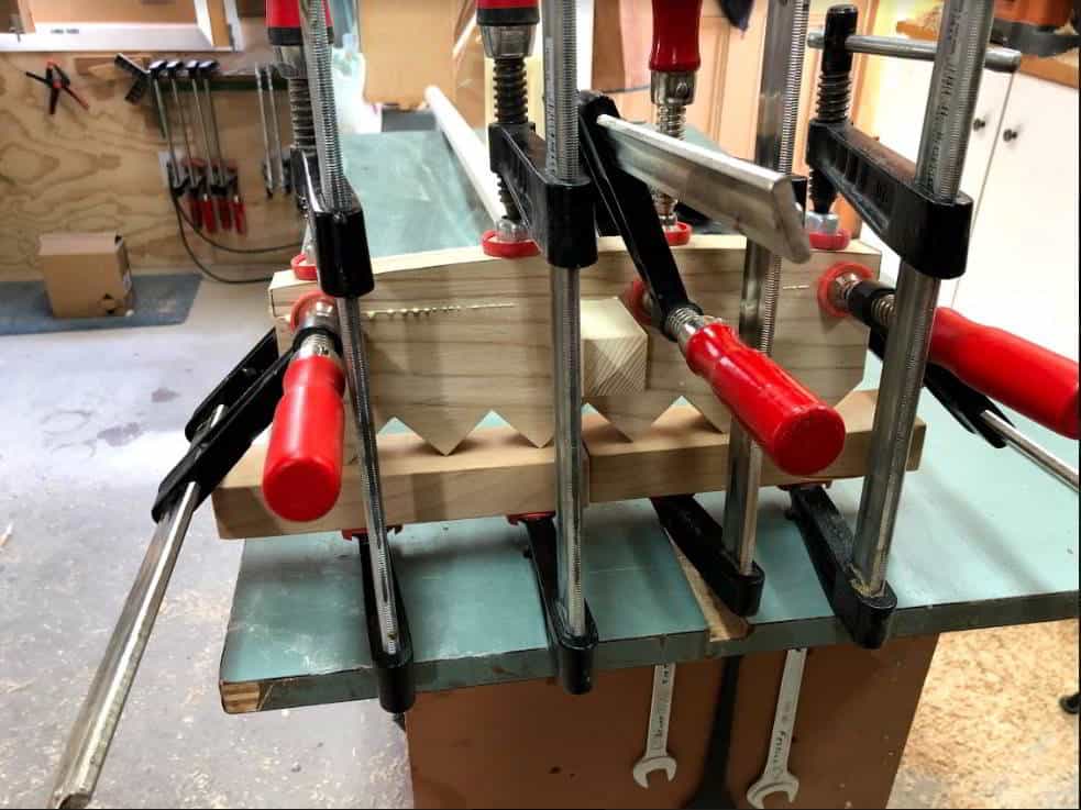

It took me about three hours to make, and even the process was somewhat Zen-like. I had some flexibility with the design details and there were only three workpieces to concern myself with. This simplified the project a lot. I broke out the handle and machined it square, then notched the head to accept the handle so the top of the handle and head were flush. Next, I spent a bit of time shaping a large portion of the handle with an octagonal cross-section, then added a few tiny details close to where the handle and head meet before I cut the large tines into the head. I was almost there. I glued these two parts together, then shaped and glued a third part directly on top of the head to strengthen the joint between the handle and the head. A bit of sanding, some chamfering with a small block plane, and I was ready for a finish.

Gluing up
