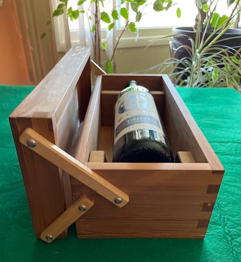

I got an email from Mike C., who sent me some images of a wine gift box he made a few years ago using a linkage hinge. Mike got the idea from a Carl Holmgren video he watched on YouTube while doing some research on retractable castors for moving machinery around the shop. A linkage hinge is both simple and ingenious. Two pieces of wood are attached to each side of the box. Because they’re different lengths and attached at different points, the lid rotates behind the box when opened. This approach to hinges could also be used to store a shelf up against the underside of a cabinet, but have it drop downward, allowing the user to access its contents. It’s certainly not rocket science, but it’s a cool idea, nonetheless.
Opened Up
The hinged box in its open position. The lid sits neatly behind the box and rests on the table surface.

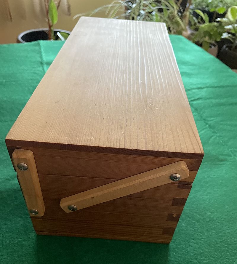

Closed Position
The pair of wood pieces on either side of the box position the lid perfectly over the box when the lid is in the closed position.
