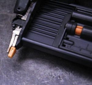

The Bostitch has a very interesting safety mechanism. Instead of the traditional foot, which must be depressed against the work, the tip of the Bostitch only needs to be touched to the work to activate the safety, so much less pressure is required to make the tool operate. It took a little bit to get used to, but I think it would be ideal for delicate operations where the extra pressure of a regular tool might cause marking on the surface of the wood, or shift a small part out of place. The Bostitch also has very consistent depth-of-drive, and leaves very small nail holes, slightly larger than the size of the nail head.
The Bostitch drove most of the nails into maple, and all of the nails into walnut at 95 PSI. The nails that did not drive into maple were crumpled. Running the nailer at 105 PSI seems to remedy the problem of crumpled nails.
Simple Safety – The safety mechanism on the Bostitch does not have to be depressed like most. It simply needs to touch the wood to be activated.

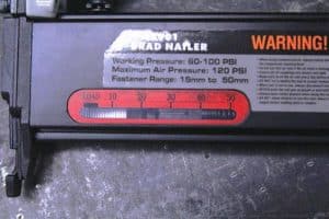

The Craftex nailer sunk some nails in the maple, but left others 3/8″ above the surface. In the walnut, however, it sunk every nail nicely, leaving a small hole the size of the nail head. At 105 PSI, it sunk most of the nails, leaving only one sticking up 1/32″.
The Craftex nailer was the shortest of all the nailers we tested at approximately 9-1/8″, about 3/8″ of an inch  shorter than the Grex and King nailers. (The tallest nailers like the Senco, Mastercraft, and TradeMaster are  just over 10-1/4″.) This smaller size will allow you to get the nailer into some fairly tight locations with ease.
The Craftex also has a low-nail warning system built into the magazine; however, unlike most, which only show when you are down to a handful of nails, the Craftex shows numerically from 0–50 nails in the magazine.
Clear Quantity – The magazine on the Craftex nailer shows you exactly how many nails are left in the tool.

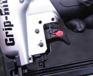

The Grip-Rite nailer was unable to countersink any nails in the maple, leaving the closest one 1/8″ above the wood. In the walnut, all nails were counter-sunk with nice small holes. At 105 PSI the Grip-Rite was able to sink all the nails in maple with nice small nail holes.
The Grip-Rite nailer uses an aluminum magazine with an easy-to-operate latch. The tool-free jamb clearing mechanism has a fairly large handle, which makes it easy to open. It also uses a decent size spring, so I don’t think it will be a service issue (see comments under Ridgid nailer). The depth-of-drive adjustment was a bit awkward to get at, but overall it’s a well functioning tool. The swivel connector is nice.
Trigger Happy – The firing mode selector for the Grip-Rite nailer is built into the trigger.
