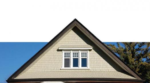

Porch Gable Wall Restoration
I recently undertook the restoration of a porch gable facade on a Victorian-era 2 1/2 storey house. The original cedar shin­gles on the porch gable had been replaced at some point with black asphalt shin­gles and the owners wanted to restore the sense of integrity to the front view by matching the cladding of the front porch gable to the larger gable above it. Those original shingles, while a bit worn and cupped, had stood up well over the cen­tury they had been in place and simply needed some fresh paint. The shingles on the gable facade I was matching were octagonally cut and uniform in width. My first task was to prep the shingles.
I used #1 Perfections (18″) for this project because I wanted a higher-end grade of shingle that would be dimen­sionally stable and free from defects. I could also have used a #2 grade, espe­cially because the shingles were to be painted, but they weren’t available at the time of purchase.

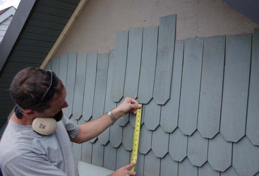

With a symmetrical pattern, you must compose it of identical pieces, ripped to a uniform width. It’s possible to buy shingles that are pre-milled and finished, but I had very specific sizes I needed, so this wasn’t an option. When the bundle of shakes comes apart, you’ll see how wet the individual pieces are in the cen­ter, and therefore prone to shrinking. The nice thing is they don’t take long to dry out because they’re thin. After a week or so indoors and spread out they were ready to be milled. They were ripped to the same width as the original shingles, and then the ends were squared with a chop saw.

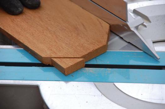

To cut the octagonal end, I adjusted the 45¼ cuts so that all three of the octagonal faces were the same length. With a simple pencil mark on my chop-saw at zero degrees as a reference for the butt end of my shingle, I would make one 45¼ cut, flip the shingle, and after lining it up with the pencil mark I would make the second cut. The first two courses of shingles needed to have no octagonal cuts on them, so I made sure I had enough of those set aside. I factored in close to 10 percent waste on this project because I was work­ing with a triangular shaped wall. The shingles were painted on all sides with one coat of paint before being installed to help seal them against humidity and wetting.

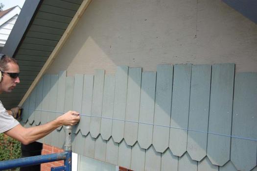

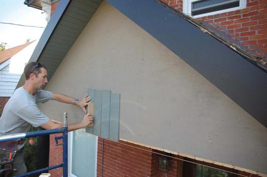

I let the first two courses begin 1″ lower than the bottom of the gable to form a drip edge, and set up a string to keep the first course straight. I used a piece of 1/4″ plywood as my key­way spacer to keep the spaces between shingles uniform and a torpedo level to check for plumb every so often. The first course was a double course and then I chalked a line for each course after that keeping my exposure consis­tent and checking for level every couple of courses. In this pattern, because each of the shingles was the same width, each butt end centers over the keyway below it for easy reference. I settled on a 5 1/4″ exposure to match the existing shingles.
The nails I used were hot-dipped galva­nized 3d box nails 1 1/4″ in length, which don’t split the shingles and feel more like pins than nails. When installing shingles, nails should be 2″ above the exposure line and 3/4″ in from the edge of the shingle and should be driven flush with the sur­face of the shingle. To protect against moisture entering a keyway, the joints between shingles should be offset 1 1/2″.

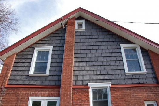

Not only are there many options in terms of patterns and layout, but you’re also not limited to cedar. Shingles are also available in pine and pressure-treated wood, and in a variety of shapes and finishes to give you lots of options. Several years ago I shingled the sec­ond storey sidewalls of my home with Enviroshakes, a composite roofing shake made of recycled rubber from tires, wood fibre, and recycled plastic from pop bottles. Textured like a split cedar shake Eviroshakes weather over time to a silvery grey similar to weathered cedar. Warrantied for 50 years, they are mainte­nance-free (you can’t paint them even if you wanted to!) and can be removed eas­ily and reused as I’m currently finding while building an addition to my home.

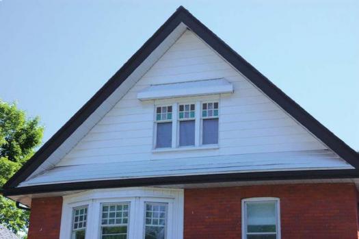

Sidewall shingles and roofing have the ability to add visual interest and com­plexity to a building, and to restore a sense of historical integrity to buildings that once featured wood shingles. A couple of years ago I had a client who wanted to restore the gable of her home to the original shingles, or as close as we could reconstruct it. Sometime dur­ing the ’70s, someone had sided it in aluminum siding and it lost a lot of its character. Imagine our surprise when I removed the siding and found the origi­nal cedar shingles beneath. We were able to just replace the small slanted section of roof at the bottom of the gable with shingles, and restored the small “roof” above the windows. Paint and caulk­ing did the rest and the transformation of the facade came about with relative ease. A comparison of before-and-after photos illustrates the way that texture and detail can transform an area from humdrum to spectacular.

Dunkin marks a line directly on his chop-saw. He then lines each shingle to the line, makes the first cut, flips the shingle and makes the second cut.
Start Low
Position the first two courses 1" lower than the bottom of the gable to form a drip edge. You’ll also notice a string set up to keep the first course straight.

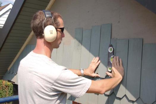

Regular Checks
 A torpedo level keeps the shingles aligned, while a piece of ¼" ply keeps the keyways even.
Matching Details
 Though it’s not an exact science, Dunkin settled on a 5 ¼" exposure to match the existing shingles.

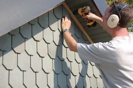

Reduce Splitting
 Predrill small face shingles with a small drill bit, then nail carefully. Be sure to not drill into the cladding below it.

 Aluminum siding (below) on this sidewall was removed to find existing wood shingles (above). Though not everyone is going to be this lucky during their reno, the differences are visually striking.
