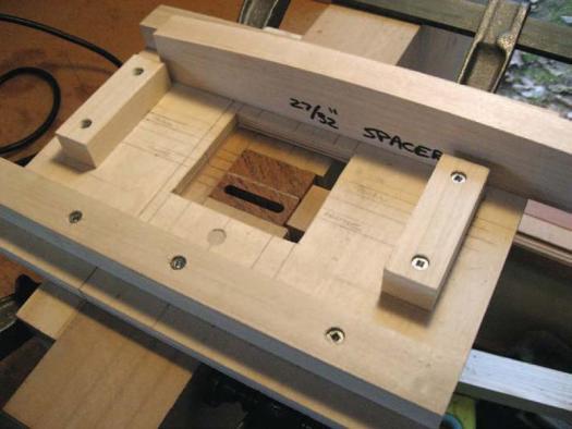

Since the stretchers on this coffee table are curved, it’s easier to use loose tenons for all of the joints. I start by cutting mortises in the ends of each of the stretchers, using a jig that holds two stretchers in the same orientation as when they will be glued up.
A plunge router with a 1/4″ spiral up-cut bit cuts the mortises. To ensure the gap between the two mortises is consistent on all of the legs and stretchers, I use a jig with a 27/32″ spacer to offset the router so the gap between the two mortises in the stretchers is the same as the gap between the leg mortises.

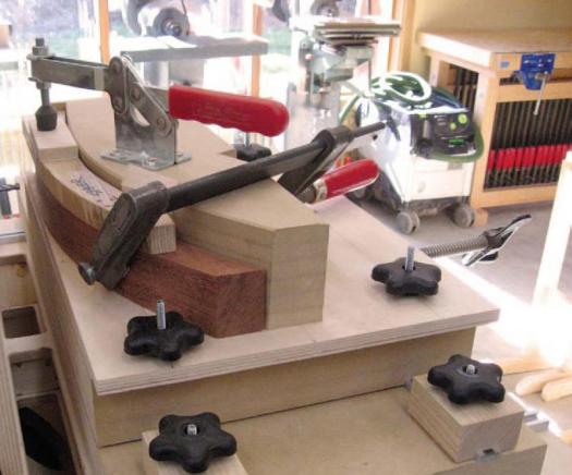

To cut the two mortises on each of the legs, I use a shop-made horizontal mortising machine with a jig to hold the leg in the correct orientation. A plunge router with a different jig could also be used. The same 27/32″ spacer is used to ensure that the gap between the two mortises will mate with the stretcher mortises. In order to prevent blow out when cutting the mortises, I temporarily fasten a piece of veneer to the outside of the leg using double stick tape.

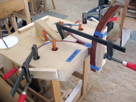

To keep the parts aligned correctly I glue two stretchers and one leg at a time, with the help of a jig. I dry fit all of the parts and wipe some wax on the pre-finished surfaces of the legs and the ends of the tenons so glue doesn’t stick to any exposed surfaces. I use Claphams beeswax polish from Lee Valley. Be careful not to get any wax on the tenons or in the saw kerf for the wedges.
After disassembling the joint, I apply glue to the mortises in the stretchers and to the ends of the tenons, and insert the tenons into the stretcher mortises, tapping them into place. Next, I apply glue to the mortises in the leg and a little to the ends of the tenons, and use clamps to close the joint. I immediately remove the clamps, then glue and insert the wedges with alternating mallet taps to ensure the wedges finish at the same depth before re-clamping the joint. The clamp caul I use has been relieved where it will fit over the tenon.

In order to accurately rout the mortises in the stretchers, a well thought out jig is used in conjunction with a spacer. The spacer is easily moved from one side to the other in order to position the router perfectly.

Milling the Leg Mortises
A second jig positions the leg to cut mating mortises. Note the spacer on top of the workpiece. For the next cut, it will be placed below the leg.

Assembly
A jig is used to accurately position two stretchers and a leg during each stage of assembly.
