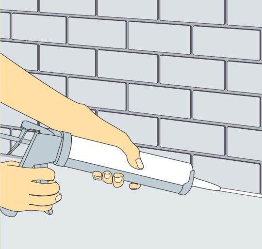

If you’re installing a tile backsplash, instead of grout, use caulking to seal the bottom row where the tile meets the counter. This will pre­vent grout from cracking if the counter flexes. If the existing grout is starting to chip, remove it all (as described above) and replace it with colour-matched caulking.
