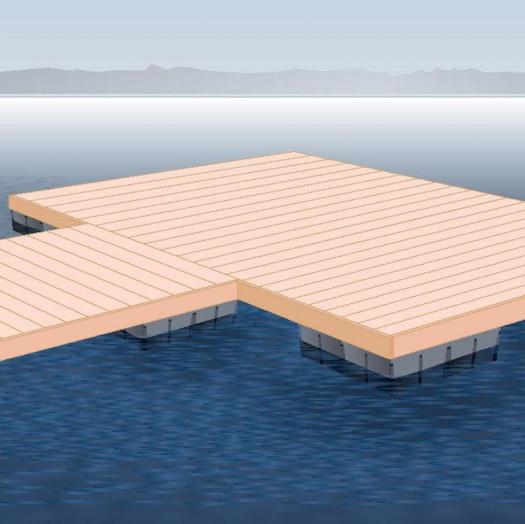

Floating docks
Floating docks are built atop some sort of buoyant material – rigid board insulation or moulded plastic drums – to keep the deck boards above water. One end is usually connected to a ramp leading to shore, while the other is tethered to the bottom with removable anchor weights for stability.
Floating docks move with the waves, not to mention when someone dives off the end, but on the upside, if the water level changes drastically, the dock top will remain a constant distance from the water’s surface.

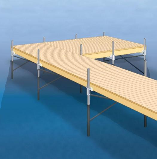

Pipe docks
Pipe docks sit on, appropriately enough, aluminum pipes that rest on the lakebed. One advantage with pipe docks is that they tend to be fairly stable. Someone leaping off one corner won’t push the opposite end up in the air. The deck itself is usually kept out of the water, reducing the damaging effects of rot. Pipe docks can be raised or lowered as water levels fluctuate throughout the season.
Many pipe dock kits come with a set of wheels to help with the chore. For docks with a large surface area, you’re wise to break it down into several lighter-weight components that you latch together.
Want to avoid that task? If you’ve got some extra money in the budget, and space along the shoreline, you can invest in a cantilevered system that allows you to lift the dock right out of the water from dry land.

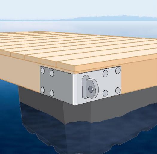

For the framing and deck boards, pressure-treated lumber is the cheap and durable option, but you’ll want to make sure it’s allowed on your lake. (If you do use PT wood, make sure you cut it and apply offcut sealant well away from the waterline.) Cedar is nice but needs maintenance. Composites are durable, but you’ll want to invest in good quality material to avoid hot-footing across the dock on sunny days.
A dock is the last project you want to cheap out on with hardware. The foot traffic, jarring boat dockings, and constant pounding of wave action put a lot of strain on the frame. You’ll want to invest in good quality galvanized brackets, corner braces, hinges, nuts and bolts.
