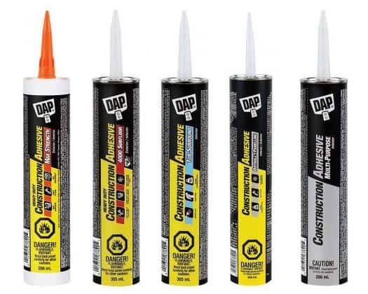

Waterproof Adhesives
Polyurethane adhesives, like DAP Polyurethane and Lepage PL Premium are not only strong, but waterproof. (Photo 2 by Lepage)

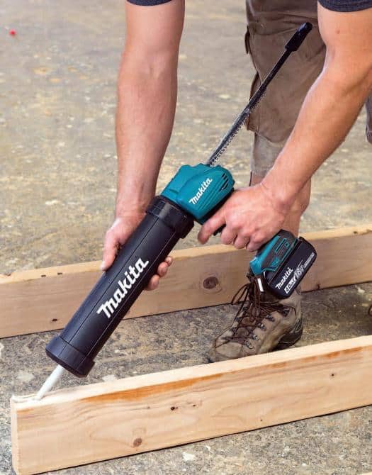

Cordless Caulking Gun
If you’re applying a lot of caulk on a regular basis, and want the job to go more easily and quickly, a cordless caulking gun is a great solution. (Photo by Makita)

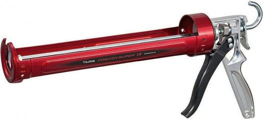

Caulk Guns
Unless you plan to use it only once or twice, a quality caulk gun will assist you in easily putting down just the right amount of caulk. (Photo by Tajima)

Three main types
There are three types of construction adhesives. Traditional sol­vent-based adhesives cure when the solvent in them evaporates. Water-based latex and polyurethane adhesives cure when the water in them evaporates; these adhesives are also ultra-low or have no VOCs (volatile organic compounds) and are virtually odour-free. While all adhesives are water- and weather-resistant, polyurethane adhesives, like LePage PL Premium, are waterproof.
General-purpose adhesives, such as DAP’s “Multi-Purpose”, work well for a variety of common indoor building materials. Some adhesives are solely for outdoor use, while others can be used both in and outdoors. There are high-performance adhe­sives for jobs that require high shear and peel strength, like DAP’s Max Strength adhesive, as well as specialty adhesives for­mulated for use with masonry, foamboard, drywall, panelling, glass, tile and roof tiles.

Construction adhesives are typically sold in 10-ounce (195ml) and 28-ounce (825ml) cartridges for use in caulk guns. Unless you’ll be using a single tube of adhesive, opt for a premium caulking gun like the Tajima Convoy, which has a durable cradle rather than rails to hold the tube, and uses a smooth-rod drip­less feature that requires less squeezing pressure to dispense adhesive. Caulk guns are available in thrust ratios from 3:1 up to 26:1. The thrust ratio is the amount of force you apply to the trigger in relation to the force that pushes the adhesive out of the tube. For adhesives with a thick consistency choose a gun with a thrust ratio of at least 18:1.
Anyone working with adhesives on a regular basis will find it considerably quicker and easier to use a cordless caulking gun. The Makita DCG180ZC, for example, has a feature that prevents adhesive from dripping when the trigger is released, along with a variable speed dial that enables you to vary the application speed and a variable speed trigger to control application precision.
