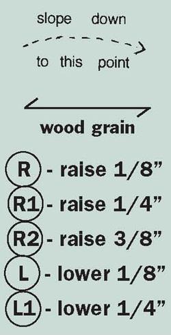

Once you have the pieces fitting to your liking, raise and lower any pieces the pattern calls for, or that your imagination suggests.
Raise and Lower
Raise by gluing scrap plywood to the bottom of pieces, lower by resawing or sanding pieces thinner. Assemble all the pieces again and draw reference lines.
These lines will help with the shaping.
