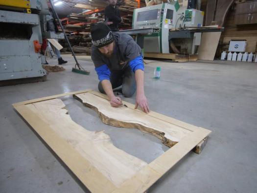

I’m usually working for a client so the size is already determined, but perhaps you’re building this with a size range in mind. Either way, we need some lumber. Using some cheap sheet goods I like to make a frame of the size of table I’d like to create to help me view the wood’s grain characteristics properly. I lay the lumber out how I like, then place the frame over the lumber, so I can visualize as close as possible what the end result will be. Covering up the unwanted wood makes this step a lot easier to get right.
Check your wood
With a good idea of what the general size of the future table top will be you can play around with the material you have to see if you can make it work. Sometimes, even though you want a top of a certain dimension, the material you have on hand doesn’t lend itself to that. Just ensure you can indeed obtain the solid wood parts needed before going ahead with the construction of your form.

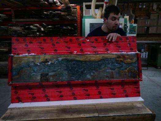

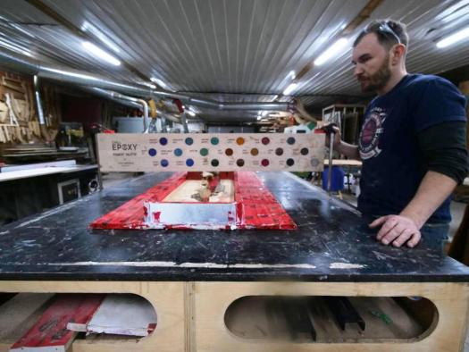

Build the form
I like the KISS method, so let’s keep this simple. I like to use 3/4’’ particle board, and cover the surfaces that will touch epoxy with Tuck Tape sheathing tape, so the epoxy doesn’t stick to the form. The form is joined together with screws and latex caulking so it’s strong and will hold the liquid epoxy during the pour.
First, cut the bottom to size. I like to build the form about 1/2’’ wider and longer than the finished size of the river table top. This will give you some material to trim off after the epoxy has cured. Tape off the entire surface of the interior side of the bottom with the Tuck Tape.
Dealing with how to attach the sides to the base is personal preference. Because I make many of these table tops I keep a selection of form bottoms on hand so I don’t waste time and material. If a piece is large enough to use as a bottom, I go ahead and cut the sides to fit on top of the bottom before securing them in place with screws and caulking. If I was just making one river table top, I would likely cut the bottom to size and attach the sides to the 3/4″ wide edges of the bottom.
Next, cut your side pieces to length and width. You’ll need them to be taller than the thickness of your lumber so epoxy doesn’t overflow. Completely tape off these pieces, being careful to fully overlap the seams and lay the tape down nice and smooth. Any bumps in the tape now can make more work later on. Place a bead of latex caulking along the edge and screw the pieces in place. I like to be liberal with the sealer as this form needs to be water tight. You could pour about one hour after you seal the form, but I suggest waiting overnight just to be sure.

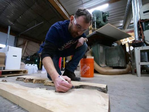

Prepare the solid wood
Depending on where you get your lumber, it may be surfaced flat or it may still be in rough form. Either way, you want to have your lumber surfaced flat and cut to size to be able to fit into the mould.

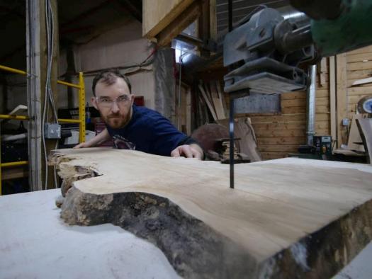

With the size of the form cavity in mind, draw layout lines onto the lumber. Once you’re sure of the locations that you will cut the lumber, trim the parts so they all fit nicely together in the form, with the all-important gap for the epoxy to flow into.

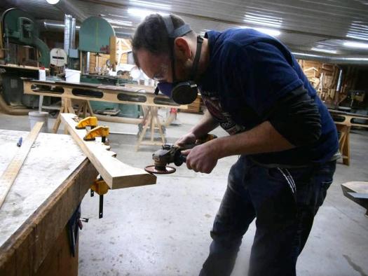

I suggest removing all the bark and loose debris. This can be done by sanding it smooth, or using a wire brush. There’s a chance you’ll even have to use an angle grinder with a power carving wheel, or some hand tools, to ensure the live edges of the material look natural when brought together. If you happen to have a sand blaster you can fill it with crushed walnut shells. This works incredibly well for very burly edges.

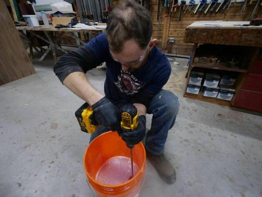

Mixing the epoxy
Mixing and pouring the epoxy is where the fun starts. There are many types of thick pour epoxy products available. For this pour I’m using an epoxy designed for up to 2” in thickness. Follow the manufacturer’s suggested instructions. In general, thick pour epoxy products are designed for different material thicknesses and volumes at 20 to 22 Celcius. Depending on your environment, you may have to have fans blowing, or air conditioning running. When the epoxy is curing I like to see the epoxy stay below 30 degrees Celcius. There is certainly a learning curve when doing thick pour epoxy projects, but with each pour you’ll have a little more understanding of exactly how epoxy reacts in your environment. There is certainly a learning curve when doing thick pour epoxy projects.
I mixed up the product in a 5 gallon bucket with a silicone drill mixer at 2:1 ratio by volume. Make sure to mix for 5-10 minutes and scrape the sides and bottom while you mix. To be extra safe you can transfer into a new pail, removing the chance of any unmixed product on the sides or bottom of the container.

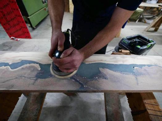

Sanding and finishing
Sanding is done just as you would with a solid wood top, how high of a grit to sand to will be determined with the type of finish used. With a Rubio Monocoat oil finish I sand through to 220 grit, Osmo oil 320 grit, Odies oil 400+ grit. If you are into spray finishing then a 220 grit sand and your typical spraying process will work great. While going through the process you’ll come across spots that you’ll need to touch up. This can be done with a 5 or 20 minute epoxy, but remember if an epoxy is cured you need to rough up the surface for a good bond. CA glue is also an option because it is so viscous it can flow into spots that are hard to get epoxy into.

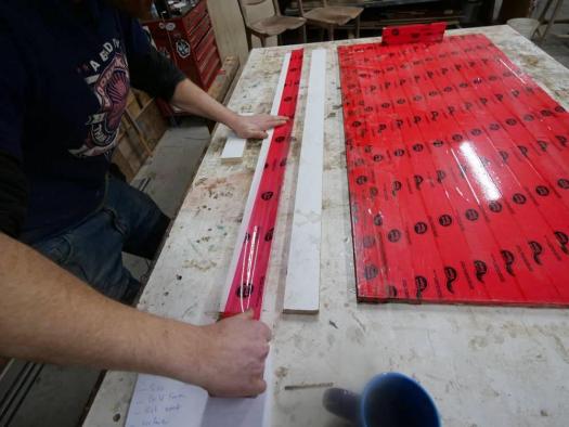

Cover it in Tape
Tuck Tape, a construction-grade adhesive tape, is applied to the inner surfaces of the form before the form is assembled. It will stop the epoxy from adhering to the form as it cures.

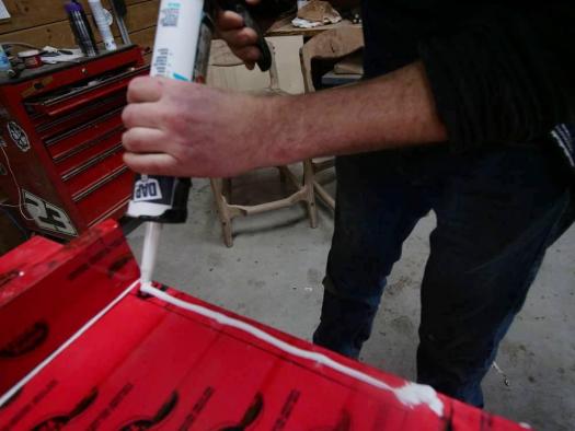

Seal the Joints
Because the joints all need to contain liquid epoxy, they need to be watertight. A healthy bead of caulking will help with this.

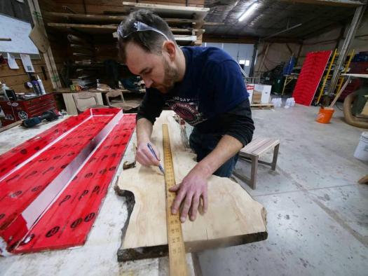

Mark the Lumber
Most lumber will need to be trimmed to size. Mark it with a straight edge, being sure the lumber will look good when matched with any other pieces you're using, and will be sized appropriately.
Frame It
 Lemiski will sometimes make a very simple frame the size he wants the table to finish at. He can then arrange the lumber on the ground or bench, put the frame on top of the lumber to get a good view of what the arrangement will look like, then trace the cut lines onto the lumber. This step can also take place before the form is built.
Trim it to Size
Carefully cutting the lumber to dimension will help you use less epoxy. The more curves there are in the edges of the lumber, the more volume the epoxy will have to fill.
Minor Adjustments
Sometimes the lumber you're working with isn't perfect. Marking the material where it needs to be removed will allow you to coax a more pleasing design from the material you have on hand.
Shape the Wood
 Often the wood you have will work nicely, but that's not always the case. Some rough machining will go a long way to providing you with a visually pleasing 'river' of epoxy. Here, Lemiski is using an angle grinder to remove some material.

A Thorough Mix
A drill and a paint mixer does a good job of mixing up the epoxy. It's critical to ensure the epoxy is completely mixed or parts won't dry.

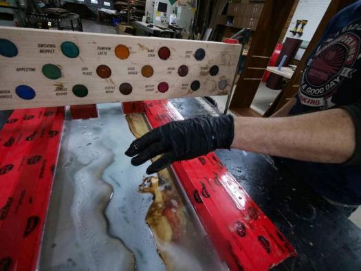

Flood the Form
Once mixed, pour the epoxy into the form and let it flow out. There's no reason to rush at this stage, as epoxy dries very slowly.

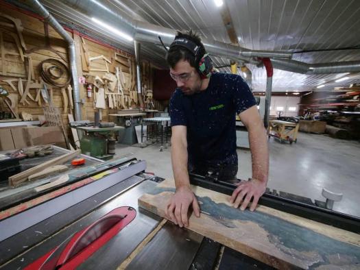

Machine Normally
Cured epoxy can be thickness planed and cut to size with a circular saw blade, like any regular piece of solid wood.

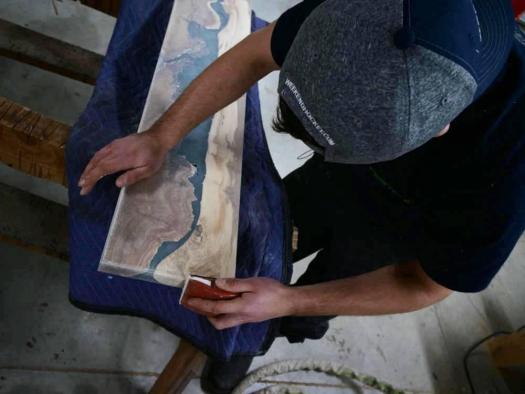

Sand it Smooth
Whether you're sanding solid wood or epoxy the same rules apply. Smooth, even passes, progressing through the grits, until the surface is ready for a finish. At this point, any air pockets can be roughed up and filled with epoxy to create an even surface for accepting a finish.
