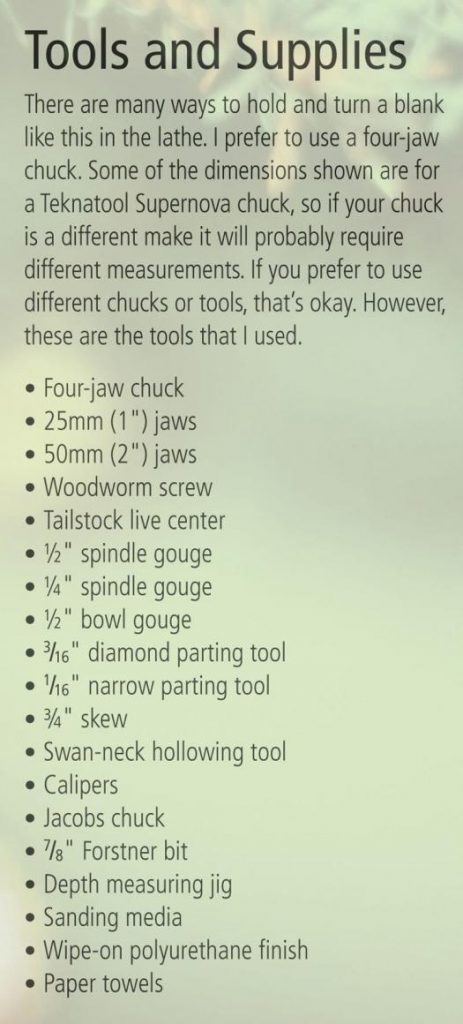

There are many ways to hold and turn a blank like this in the lathe. I prefer to use a four-jaw chuck. Some of the dimensions shown are for a Teknatool Supernova chuck, so if your chuck is a different make it will probably require different measurements. If you prefer to use different chucks or tools, that’s okay. However, those listed above are the tools that I used.
