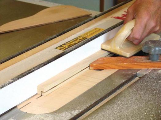

You can also cut the rabbet on the table saw. This is a good choice if you have a lot of moulding to make; it’s much quicker. You can use either a standard blade or a dado set. With the standard blade, two intersecting cuts remove the waste, while a dado set can plow out the rabbet in a single pass if it’s not too deep.
When making two cuts with your standard blade, be careful as you make the second cut that the waste piece of wood releases to the outside of the blade. If it becomes trapped between the blade and the fence, you risk a dangerous kickback. Whether using a regular blade or a dado set, a featherboard will help give safe and consistent results by holding the workpiece firmly against the fence.

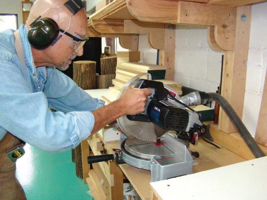

Instead, cut your moulding to approximate lengths – the finished length plus another inch or so, depending on the frame’s size. Make 90° cuts. This will give you two pieces of moulding, about the size you need, that are easy to manage.

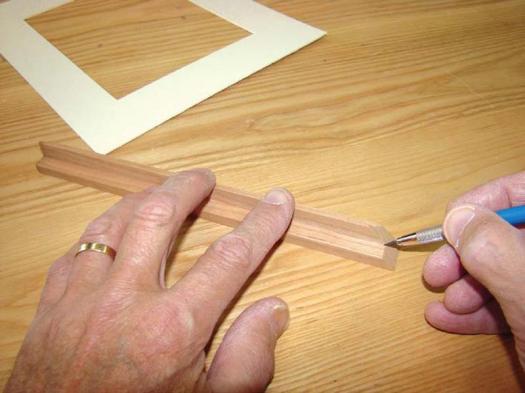

Place one of the pieces of moulding on your bench so that the rabbet faces down against the bench, and the profile you routed faces up. Mark a 45° line from the outside corner of the moulding across to the inside (profiled) edge. It doesn’t have to be accurate; it’s only a visual aid to show you the direction in which to cut. Cut that mitre on each of the pieces, giving you four pieces of moulding, each with a mitre at one end and a straight cut at the other.

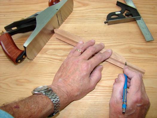

But when you do have to measure your moulding, here’s the trick to ensure you do it right. Don’t measure from the longest point, where your 45° cut crosses the outside edge of the moulding, and don’t measure from the shortest point, where the cut crosses the inside edge. Instead, measure from where your cut crosses the rabbet (see photo). Think of Goldilocks and the three bears: the outside is too long, the inside is too short, but the middle of the rabbet is ju-u-u-st right.

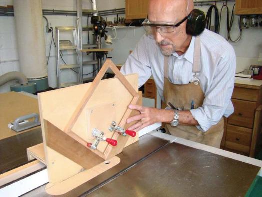

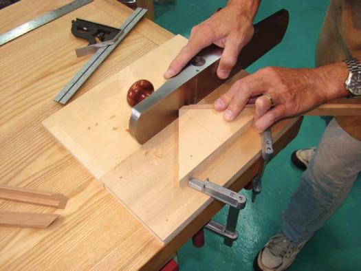

If you used a chopsaw with a good blade or an accurate mitre sled on the tablesaw, you should have four perfect 45° mitres ready for gluing. Mitres cut by hand usually need some trimming to make them accurate and neat enough to glue. Do this with a finely tuned low-angle hand plane and a mitre shooting board.
The shooting board is a simple jig that holds the moulding at an accurate 45° angle while the plane trims it. Make one using some scraps of plywood: one for a base, a thin piece for a raised platform, and a third piece for a fence. The thin platform guides the plane and raises the workpiece above the plane’s side so the blade can make a full cut. Two sides of the fence must form a perfect 90° angle. Check this with an accurate square, then attach it to the platform so these sides meet the platform’s edge at a perfect 45°. Stick pieces of 120 grit sandpaper to the faces of the fence to prevent your workpiece from slipping and you’re all set.
When using the jig, make sure you plane “downhill” as shown in the photos so that you’re planing with, rather than against, the grain. This is a very fine cut, so I like to set up my plane using an extra piece of moulding with a mitre cut on one end. This is the Braille method: it relies on touch rather than sight. Retract the plane’s blade so that when you make a pass it doesn’t cut any wood at all. Very gradually advance the blade while making more test strokes. The blade might scrape a bit of sawdust off the end of the workpiece and then – if it’s truly sharp – will take a fine, almost transparent shaving.
That’s what you want. If you glide the plane forward and it goes “Thunk!” when it meets the workpiece, the blade is advanced much too far. To repeat: This is a very fine cut. Once setup is done, a few strokes of the plane should give you a perfectly smooth and accurate mitre, ready for gluing.

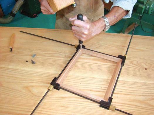

You have a choice of clamps to use. Right-angle clamps secure each corner separately. They work fine but if your angles are off, cumulative error can add up quickly. Regular bar clamps also work fine, but again watch your angles. Check that your frame is square by measuring from corner to corner, then making a second measurement between the opposite corners. If the measurements are identical, it’s square. If not, squeeze in the longer dimension until it matches the shorter one, then tighten up the clamps.

My favourite clamping method is to use the Veritas 4-Way Speed Clamp sold by Lee Valley. This clever combination of right-angle corners, threaded rods, and speed-clamping nuts not only clamps a frame evenly, it also pulls it square. Once you have cut and mitred the sides of your frame, place them face down on your bench-top inside the clamp. Then slide the cross-drilled brass nuts along the rods until they meet resistance. This forces them straight so their threads engage and they can be tightened up around the frame.
Thread the nuts until the clamp barely snugs up around the frame, then push all four sides of the frame down flat onto the desktop so everything is in the same plane, and tighten up the nuts. Now turn the clamped frame over and check the mitres to make sure there are no gaps. If there are, it’s back to the shooting board for a bit more plane work. If all the mitres are nice and tight, you can open up the clamp, spread a bit of glue onto the joints, clamp the frame and set it aside to cure.

A much better option is to use V-nails. These are metal fasteners shaped like the letter “V” (duh!), which are far stronger and more stable than brads. They are pressed or driven into the back of the mitre, drawing it together and holding it fast. Lee Valley’s V-Nail & Brad Driver (86K87.10) gives you a V-nail driving tool and enough V-nails to make dozens of frames, or their V-Nail Press (86K33.01) for $132.00 provides a tool adequate for light production work.
Using V-nails is simplicity itself. The driving tool has a magnetized plunger that holds the nail. All you do is place the nail on the driving tool, position it so its “wings” are aligned with the sides of the frame, and drive it home with a mallet. In a wide frame, three or four V-nails can be used along the joint for greater strength.

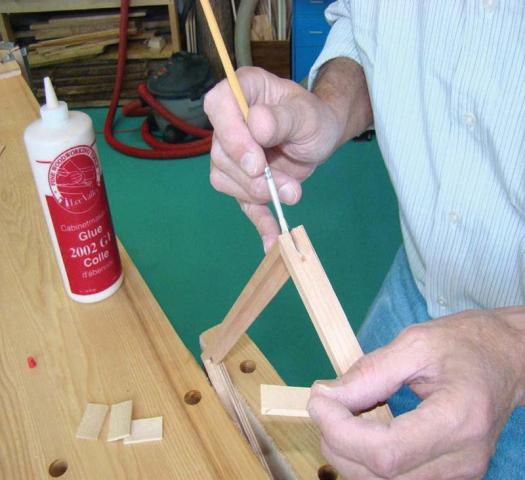

Glue hardwood keys into the slots. Take care to brush glue into the slots instead of onto the keys to minimize squeeze-out. Once the glue cures, carefully cut off the waste ends of the keys using a flush-cutting saw so as not to mar the frame’s surface. Be especially gentle right at the corners where the wood is prone to chipping out. Once cut, trim the keys flush using a low-angle block plane. Plane in from the corners to avoid chip-out.

When cutting the rabbet with two cuts on the table saw, be careful that the second cut releases the waste piece on the outside of the blade. If it is trapped between the blade and the fence, you risk a dangerous kickback.
Start Straight
A chop saw makes short work of rough-cutting your frame pieces to size. Perry likes to make the first cut at 90° to break the stock out.
Think Twice, Mark Once
The pencil marks the spot you measure from: at the point where the mitre cuts across the rabbet.

Simple and Accurate
A mitre sled on the table saw is a good alternative to the chop saw for cutting mitres.

A bevel-up plane like this low-angle jack is ideal for shooting the mitres.
Clamp and Reinforce
The Veritas 4-Way Speed Clamp holds the frame tight and square while V-nails are driven into the backs of the mitres.

Brush glue into the slot instead of onto the mitre key to minimize squeeze out.
