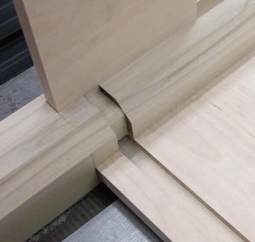

Salusbury bored a hole in the inside corner of the notch in the bottom, then used a band saw to make the straight cuts. This notch will fit around each leg.

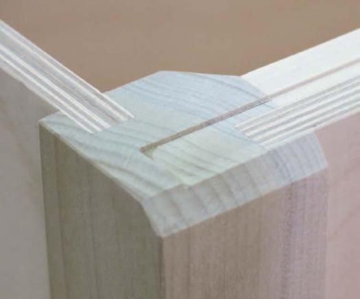

The grooves cut into the inside surfaces of the legs will accept the bottom panel, and are aligned with the grooves in the panels.

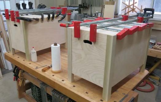

Assembly happens in stages to make the process simpler and less stressful. Start with bringing a side panel together with two legs, and repeating the same process on the second side. When dry, bring those two assemblies together with the remaining parts and clamp everything together.

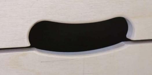

The handles were cut before the lid was cut from the base, so accurately locating the handles is important. The front handle straddles the lid and base, while the two side handles are completely in the base.

Flat-bottomed grooves make for an even look once the piece is assembled, and the lid is removed. These are also strong joints that will stand the test of time.

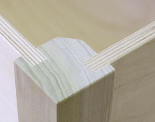

So now that we know the direction we’re heading in it’s time to mill the leg stock and cut it to final length, followed by routing dados in it. I also chamfered the inner corner of each leg to make the box friendlier inside; the chamfer was shaped after routing the dados, maximizing the working surface and stability during dadoing.
I prefer routing over using a dado set on a table saw; the joinery will be fully exposed when the lid is opened and saw-blade dado sets are notorious for producing uneven surfaces at the bottom of the joint.
All the dados are stopped at the lower ends, so a stop-block gets clamped to the router table fence. I find ripping the long dados first makes crosscutting the short dados easier by providing a void behind the cut.
The dados that accept the top and bottom are the same, short of the fact that the dados for the bottom will be cut well in from the bottom end of the legs. The top dados will be machined at the top ends of the legs.

With the panels cut to final size, I refined the corners of the bottom and top panels to fit around the legs inside the dado, sanded the panels to P220 grit and eased the edges so they shoehorn into their respective dados firmly, yet effortlessly. The joints at the four corners of the top are not going to fit perfectly, but the three top trim pieces will eventually cover up any gaps that are visible.

I located and shaped the hand holds in the case using a hand-held router with a router template I made while the case was curing; end handles for lifting the box and one up front to raise the lid. Alternately, hardware handles could be applied later to suit the application and decor. Regardless, accurate location of the cut separating the box lid from the box base needs to be determined at this point.

To assemble the box, I begin by lightly sanding all parts to remove any fuzz and gently ease all edges so the panels will slip unimpeded into the dados then dry-assembling to make sure of fit and alignment. Next, this time with glue, sides get joined to legs first. I align the dados by inserting a scrap plywood block within the joint as the parts come together. Once dry, these subassemblies are united with the back panel, top, bottom and front panel. Band clamps can be useful here to surround the assembly while checking for squareness and any other unexpected surprises.
Working steadily, it’s time to stand the case on its feet on a known level surface and apply clamps, checking for squareness all the while, making adjustments if required. If the millwork, joinery and panel dimensioning were cut exactly, the assembly should self-square perfectly.

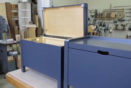

Hardware and hinges were applied once the finish fully cured. Here I used a piano hinge at the rear of the box/lid and bumpers of the same thickness as the hinge, where the lid contacts the front legs to maintain the gap between the elements. I also added a friction lid support to hold the lid open when needed. Lastly, glides were installed on the bottom of the legs to ease movement and provide visual lift for the completed boxes.
Side-by-side they offer comfortable seating and generous storage at the foot of a bed; one day they’ll become heirlooms for another generation.
