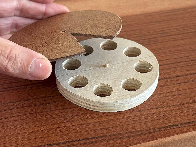

Part way through this process, I headed to the shop to knock out a quick mock-up of this little project. I find it much easier to have something to look at and manipulate in my hands, especially when there are a lot of aspects and details to consider. I knew it wasn’t an overly well-thought-out design, but it would at least be a starting point. Remember, this was only part way through the design process, so I hadn’t considered things like how hard / easy the box would be to grasp and pick up daily.
Within about 20 minutes I had pumped out a pretty bare-bones box. I mistakenly bored eight holes, instead of seven, but that’s no big deal for now. That’s a mistake that’s going to happen when you’re moving quickly. The eighth spot is going to be left without a hole, so that can be the starting point – basically on Sunday night.

Quick Mock-up
The lily pad lid can be rotated to the correct day of the week, then the entire box can be turned upside down so the pill drops out. The main worry I have is that the box might not be as easy to pick up, manipulate and put back down, while ensuring the rest of the pills don’t fall out somehow.
Quick Mock-up
Eight…Oops
I drilled one more hole than needed, but I'll pay a bit more attention next time. The lid will rotate on a pivot point, but in the real box the pivot point won't be visible from the outside.
Eight…Oops

  1. Hi Frank,
    Making the lid transparent was an option, but (naturally!) I opted for a wood top. It’s easy enough to take the lid off and check on how the week is going, but the user won’t be able to see into each daily compartment without taking the lid off. The weekly pill boxes you can purchase have a clear lid, so you can see each section, but I opted against that.
    Not a bad idea about the need to travel with this box. The pivot pin will do a half decent job at keeping the lid on, but obviously won’t be perfect. An elastic band or a ZipLoc bag could help – likely both, working in tandem would be best. I guess some sort of a latch could also work to keep the lid on, but my friend doesn’t travel much, so I didn’t need to consider that, thankfully.
  2. Hi Tim,
    Yes, I mentioned that in the column. I laid the box out with 8 spots, but the plan was to only drill 7, one for each day of the week. Hurrying, I bored all eight spots. I won’t make that mistake next time! And I agree with your thoughts about making it as small as possible. Even just to comfortably grasp / manipulate it daily (without dropping it) would be easier if it’s not too big.
    Thanks for your thoughts.
  3. I think there should be a blank spot, like eight places but one not drilled, so the lid can be closed to this spot to avoid any dust and such getting in to the pill cavities. I also think that consideration for portability might show a need to make it as small as possible. Just me thinkin’ here!
  4. As someone who takes 6 pills every day I read this with interest, but there are some practical issues to face. I just finished loading my weekly supplies of pills and realized that it was extremely convenient to be able to see that each day had all the required pills hence the pill holder needs to be somewhat transparent. Secondly, periodically I travel so my pill holder needs to be able to travel and since my travel usually spans a weekend the usual 7 day schedule needs to be modified by preloading the beginning of the second week. But the idea of a more attractive holder is interesting.
  5. Hi Charles. Yes, multiple pills aren’t an issue with my friend, though it would be for many. Larger holes in a larger base would be the answer. I’ll mention that in the article.
  6. Hi Walter. I may not have mentioned it in the blog, but I’ll definitely be adding some sort of very simple “day of the week” markings. Not sure what yet. I don’t think a clear top is necessary in this case, but I could see it in many cases. I’m hoping the single opening, and the day of the week labels, will be enough for this person to keep track of. They are still young and not very forgetful.
  7. I’ll be following this closely as I too know someone with a similar problem and I’ve been ruminating how to make a fix from wood. In this case though ,it would require space for multiple pills. I like your idea of going with a round box though.
