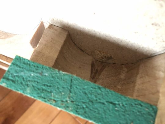

Three ramps were enough, and we decided to direct the marble around to the back side of the board. Curves require something a bit different; either a curved piece of wood needs to be cut or you have to incorporate a piece of recycled material into your run. We chose the later, and got to work cutting the lid of a Rustoleum aerosol spray can to fit our requirements. We attached it to a plywood base, smoothed the transitions, formed a hole in the particle core base to bring the marble back to the front of the marble run and off we went.

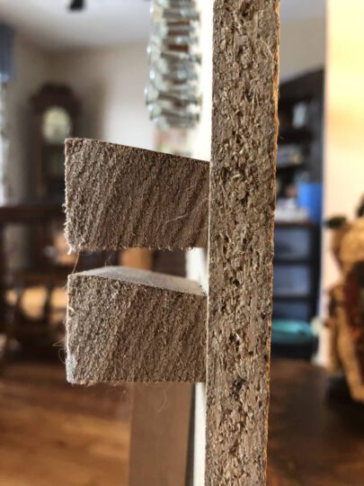

If the ball went right, it bounced down a level and tapped the tops of a series of rungs, making different notes as it went. In our minds the notes the marble played were loud and clear, like the New York Philharmonic. In reality, the notes were quickly played and off tone. We liked the ugly song it played, though. And because we drilled holes in the tops of the slats that fit over the nails, we could reposition the slats to get a different ugly song. A short ramp led the marble to my son’s favourite part of the run – the jump.

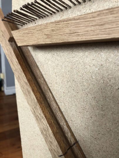

Okay, back to the Plinko screw maze, where the marble could choose its own adventure. If the marble went left instead, it moved down a set of closely spaced finishing nails, making a very pleasing sound. The three levels of nails work nicely now, but they were not easy to make. We knew the nails needed to be spaced close together so the marbles wouldn’t bounce, but the angle gave us lots of problems.
We started off with the nails at far too shallow of an angle, so the marbles didn’t travel down the nails. Next, we increased the angle. Far too much, apparently, as the marble bounced wildly down the row of nails. We decreased the angle, only to find out the angle was still too steep. Our fourth time was a charm, as once we nailed the angle of the nails the sound the marble made when it moved over each row of nails was truly music to our ears. Smooth, rhythmic music, with virtually no wild bouncing. We took that angle and ran with it to add the next two rows. This is my favourite part of the run.

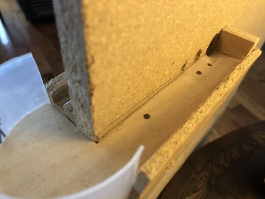

The jump was a bit of a challenge, as the ball kept flying into the hanging slat above it, not to mention flying too far over the landing container we built for it. After a few adjustments, everything worked fine. We then directed the marble around to the back, through a hole in the particleboard base. If you watch the run from the front, the marble magically appears at the other side of the run, then works its way down a few more ramps, onto the floor and hits a block cut at 45° to send it away from the run.

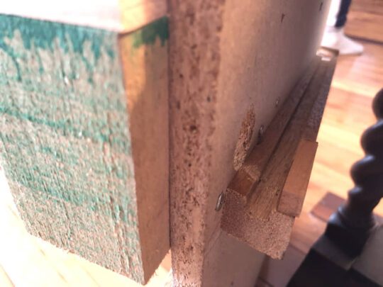

Short Ramps – If you look closely, you’ll see a short ramp filed into the end of the surface, directing the ball into the hole in the backer board. These details direct the marble and give it a short downhill slope to roll down.

Grooves – A groove to help center the marble, then direct it through the hole, was needed in the container that catches the marble after the jump.

Marbles have a way of finding the tiniest sharp edge to hang up on. Even a bit of dust can cause problems. All the corners, holes and transitions in this marble run had to be smoothed and shaped so the marble could smoothly navigate its way down to the floor. This took some patience. A few times we had to hand-shape grooves into the wooden transitions do ensure the ball entered a hole properly.
Stop Blocks – And once the marble goes over the jump, gets captured by the container and rolls along the groove we added, it needed to be further directed and controlled so it rolled along the track. A small wooden block was added to the far side of the track to stop the marble from overshooting the track.
