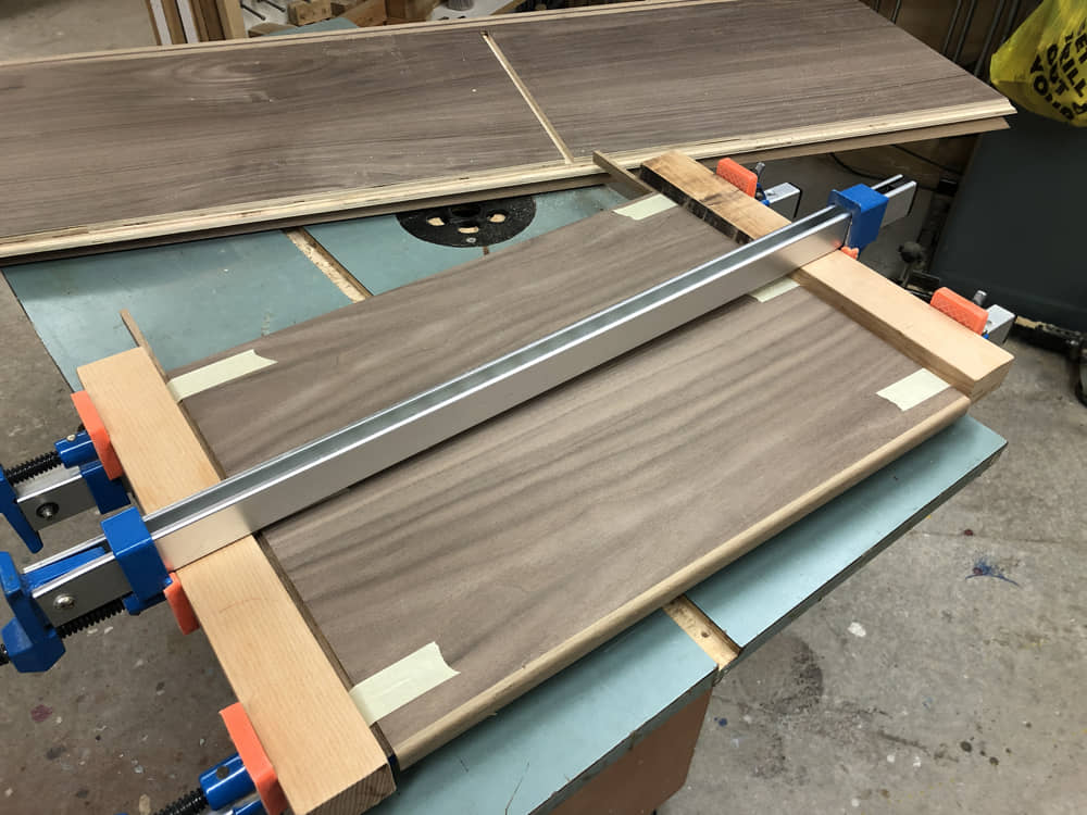

Glue a New Piece On
Clamps and cauls are used to apply pressure to the small tenon strips to both ends of the dividers.

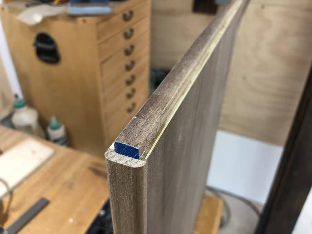

Ready for “Tenonizing”
A strip of solid wood, ready to be machined into a tenon.

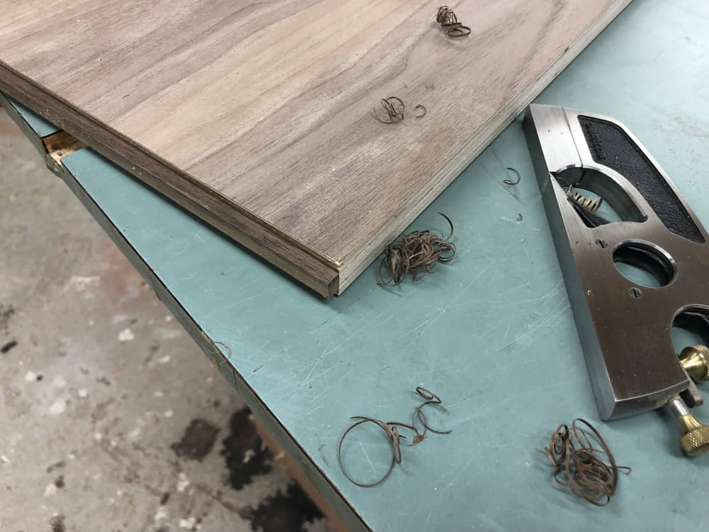

A Good Fit
After my dado set brought the tenon to a near fit, I adjusted the tenon’s width to fit the grooves with a shoulder plane.

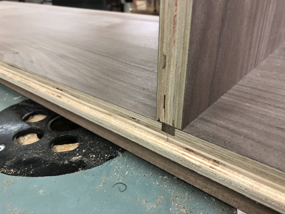

All Done
The new black walnut tenon in its final resting place. With some screws added from below and a couple of glue cleats added at the upper joint, the divider will stay in place for a long time.
