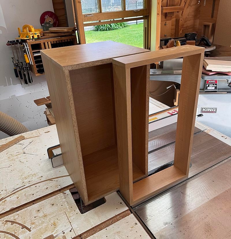

When I cut 4″ off of the front of the upper cabinet, I looked at the offcut with intrigue. It was essentially a 4″ deep frame, the exact same width and height of the cabinet. I thought it might make a good frame for some sort of key and wallet valet, or possibly for some miscellaneous bike tools that get used frequently. I hate waste, and reusing this frame might be both handy and allow me to not waste the material.

A Nice Surprise
What’s that I see? A new matching frame that just appeared out of nowhere?

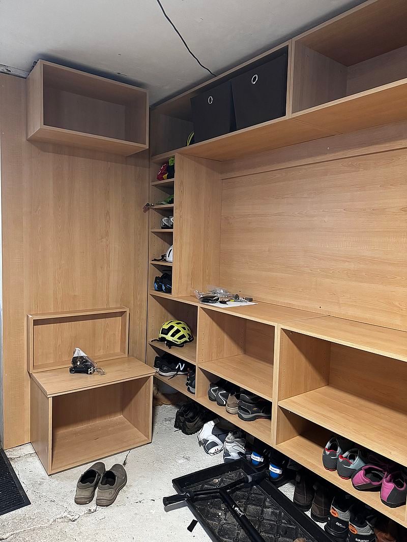

Partially Full
Not all of our stuff is put away yet, but things are looking good. You can see the bench in the lower left and the upper cabinet that needed to be cut down in the upper left. The frame I was left with after cutting the upper cabinet down is on top of the bench, awaiting a final design decision.
