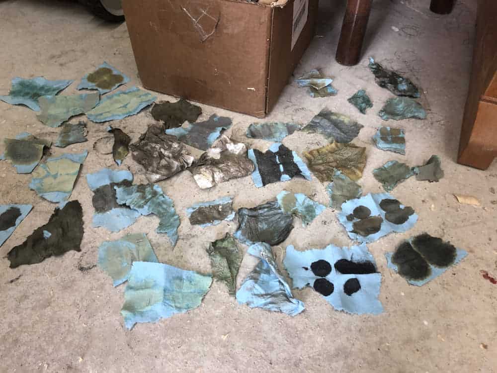

Some of Rubio’s products aren’t oil-based, so the rags used won’t spontaneously combust. Others, like their “Oil Plus 2C” products, are oil-based. Laying the wet rags out to thoroughly dry is essential to avoid a catastrophe. Shown here is only a small fraction of the tiny bits of shop rags I used to apply all the different finishes to the many samples.
