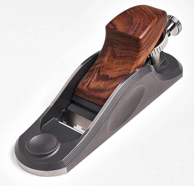

What immediately stands out is the use of titanium throughout the body and hardware. Compared to traditional cast or ductile iron, titanium brings a few meaningful advantages. It’s naturally corrosion-resistant, so rust simply isn’t a concern, even in a damp shop. It also feels neutral in the hand rather than cold, which is something you notice right away during cooler months. Perhaps more importantly, it helps dampen vibration, reducing chatter and giving the cut a smoother, more controlled feel. Because titanium is significantly less dense than steel, the body is made thicker to retain mass and rigidity. The end result is a plane that feels surprisingly substantial on the cut, yet remains agile and comfortable in hand.

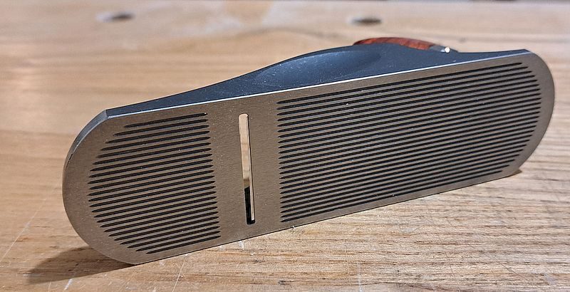

The machining on this plane is first rate. The grooves on the corrugated (ribbed) sole decrease the total surface area in contact with the wood. In theory, this means slightly less drag when pushing the plane and a bit easier movement on resinous or sticky woods. The important thing however, is that the sole is perfectly flat where it matters (at the toe, mouth and heel). Besides, I think it looks great.
Zen-Wu corrugated sole
Lovely corrugated sole.

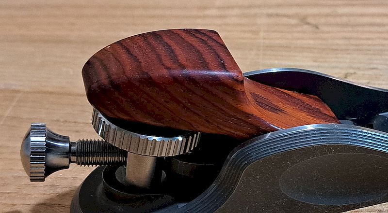

The cocobolo insert on the lever cap is a nice touch, both visually and ergonomically. It adds warmth where your hand naturally rests and provides a subtle contrast to the otherwise industrial feel of the titanium body.
Cocobolo handle
Nicely shaped cocobolo handle.
Superbly machined
Superbly machined body.

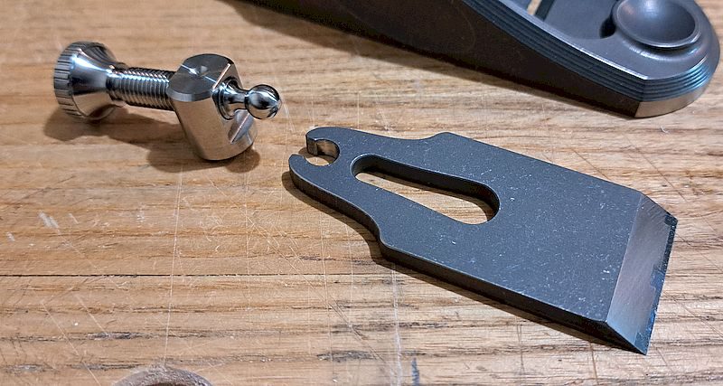

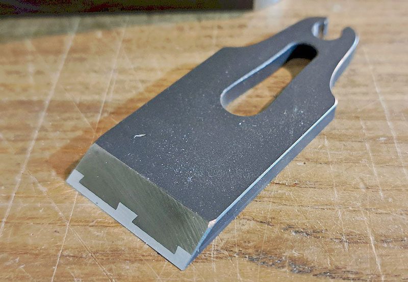

The 32 mm blade is where things get particularly interesting. Drawing inspiration from Japanese toolmaking, it combines a high-performance steel (ZW-V0) laminated to a titanium backing using a dovetailed construction. Hardened to around 64–65 HRC, it holds an edge impressively well — on par with other premium steels I’ve used — and arrives dead flat and ready to go. In use, it handled even difficult grain with ease and maintained its edge as long as any high-end blade I’ve worked with.
Laminated blade
Laminated blade.
The blade is ground flat, however, if you choose, you can hollow grind it. The dovetail construction is very solid and won’t delaminate. It’s also worth noting that the plane is designed specifically for Zen-Wu blades, so aftermarket options aren’t compatible.
The Zen Wu blade is very different than what you’ll find on conventional block plane blades. At the end of the blade is a slot that the blade adjuster engages to move the blade backward and forward. Movement is very smooth.

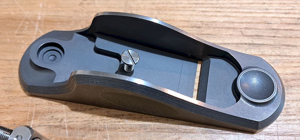

Zen-Wu has opted for a simplified adjustment mechanism in place of a traditional Norris-style adjuster. Despite having fewer moving parts, it still offers precise depth control and reliable lateral adjustment. I appreciate the reduction in mechanical complexity —it feels intentional, with fewer components to wear out or go out of alignment over time, while still delivering the accuracy you need for fine work.
The fixed mouth opening may raise an eyebrow for some, but in practice, it aligns with how this plane is meant to be used. This isn’t a tool for hogging off material; it’s designed for whisper-thin shavings and fine tuning. In that context, I didn’t find the lack of adjustability to be a limitation.
Blade adjuster and blade
Blade adjuster and blade.

In hand, the plane is compact at 150 mm long and weighs just 360 grams, but it doesn’t feel insubstantial. The added body thickness, combined with thoughtful finger recesses and balanced proportions, gives it a secure, comfortable grip. It’s the kind of tool you can use for extended periods — whether you’re breaking edges, dialing in a fit, or making small adjustments at the bench—and it really shines when it comes to fine joinery work.
Zen-Wu bock plane
A joy to use.

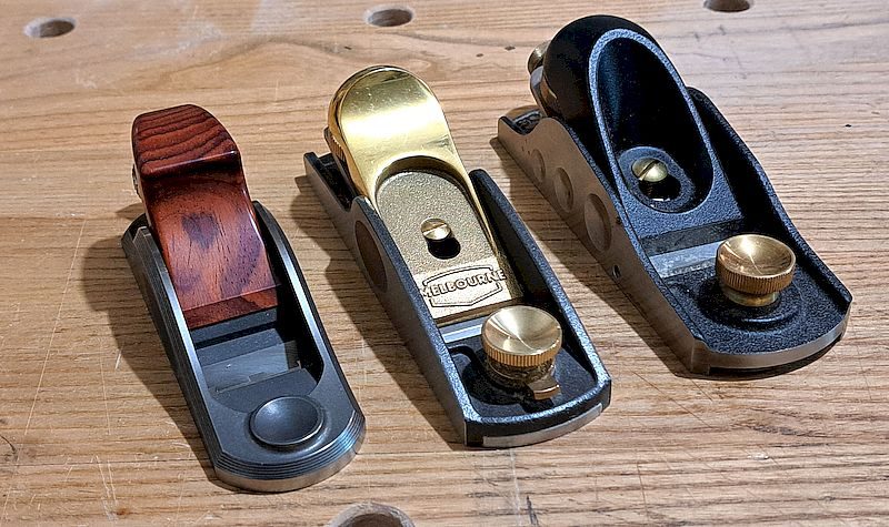

Zen Wu Veritas 05P2201 Melbourne MTC-49407
Body Titanium alloy, 150mm long Ductile iron, 162mm long Ductile iron, 162mm long
Blade ZW-V0 A2, O1 or PM-V11 M2
Adjustment style Simplified Norris-style Norris-style + set screws Norris-style adjuster
Ergonomics Compact, minimalist, wood palm rest with finger recesses Highly ergonomic with curved body and finger recesses Traditional, sleek design with finger recesses
Weight feel Light (360 g), thick-bodied Heavier (750 g), balanced Heavier (750 g), lower profile
Fit & finish Ultra-modern, boutique craftsmanship Precision-machined, refined Classic hand-finished quality
Price tier Ultra-premium ($579 US) Premium ($198) Premium ($129)
3 popular block planes
L to R: Zen-Wu – Melbourne – Veritas.
