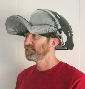

The Trend Airshield Pro ($399.00, canadianwoodworker.com) is the most recent version of their powered face shield. Unlike the Triton version, the Airshield Pro is a single, self-contained unit with all of the filtering done on the headpiece itself. The unit ships with a 3.5Ah Ni-MH battery that can be recharged without removing it from the helmet; the user can also purchase a second battery, which can be charged on an external charger and inserted when needed. Replacement of the battery is quick and easy, and battery life has been doubled on this new version, with a run time of eight hours. As an added bonus, an audible beep sounds when the battery is low. The Airshield Pro is noticeably heavier than the Triton, but with the placement of the battery pack at the rear of the helmet it feels well balanced. As expected, with the battery in the helmet the Airshield Pro is a bit noisier than the Triton, measuring 84.6dB. Air flow, which is rated at between 5.6 (minimum) and 7.06 (fully charged) cubic feet of air flow per minute, is noticeably stronger than on the Triton. Twin filters are rated at 98% efficiency, but are not NIOSH N95 rated.
The visor has also been moved closer to the face to improve the field of vision; eyeglasses end up being quite close to the visor. Like the Triton, the visor is very clear, with little visual distortion. To protect the visor from scratches, Trend offers a plastic overlay with adhesive edges that is simply attached over the visor. When the overlay is scratched or damaged, it is simply peeled off and replaced and at a cost of around $4, which is considerably less than the cost of replacing a scratched shield. Unlike the Triton, ear muffs are an optional accessory on the Trend Airshield Pro. The helmet also uses a ratcheting adjustment knob at the back of the helmet to adjust fit (you need to press on the knob to lock it in place). While on the Triton you can move the visor away from the helmet, on the Airshield you tilt the whole helmet shifts upward out of the way. There is a small removable shroud that wraps around the bottom of the helmet and sits just above the ears. It doesn’t do as good a job as the Triton in sealing off the entire head from dust, particularly around the ears. You can wear glasses under the helmet, but the fit is somewhat tight, particularly along the side of the head. The Airshield Pro, which has a one year warranty, has a lot to recommend it, particularly its removable battery and higher air flow rate.

Trend: visor up
Trend: visor up
