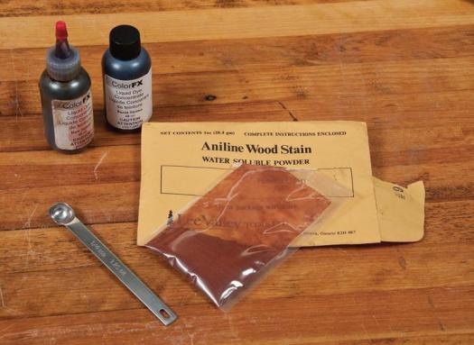

Dyes come in both powder (also known as aniline dye) and liquid form, and each has its intended use. Although both forms can be mixed with water, only the liquid form can be mixed with alcohol. Therefore, if you’re looking for a non-grain raising stain, get the liquid dye and mix it in alcohol. As an aside, I have found you can limit grain-raising by misting the wood beforehand with water, then lightly sanding it to get rid of all the ‘whiskers’ that pop up when wetted. If you sand too deeply, though, you’ll sand down to the base of the fibres. This, in turn, causes the wood to ‘whisker’ again as soon as any water-based dye or finish is applied. I’ve found this necessary for only sanded surfaces, however, so perhaps this is another reason why planing surfaces in preparation of finishing is better than sanding. As the editor of this magazine, Vic Tesolin, will attest, a sharp, well-tuned plane will smooth almost any surface faster than sanding.

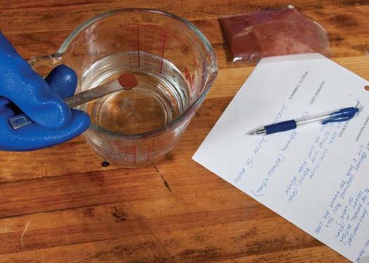

To start off right, you’ll need a glass measuring cup, a set of measuring spoons and a stir stick. When it comes to matching stains when using powdered dye, measure small amounts of both water (or denatured alcohol) and dye, then experiment with various combinations of water and dye until you’re happy. As far as matching colours with liquid dye is concerned, Wood Essence has made things easy for us by providing formulas for the most common stain colours. Because much of the guesswork has been done for you already, I’d recommend you try your hand using liquid dyes first before attempting to use the powder dyes. Whether using either liquid or powdered dye, you’ll likely have to fine-tune your stain colour to get it just right. So before you go ahead and start applying it, try it out first either on a piece of scrap left over from your project or a hard-to-see area and be willing to go back and adjust your formula accordingly. Remember to document the formula that you found worked best, as I can guarantee from personal experience that unless you write them down, you’ll forget what worked for you last time.

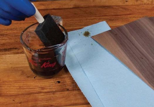

These stains can be applied by brush, rag or spray gun, so they’re very flexible. When using them to match sapwood to heartwood, I have found that a brush such as Lee Valley’s tapered round brush (part # 33K69.25) works best. If covering a larger area, I prefer a broader brush made by a reputable company such as Purdy, which is available at Home Depot (sku# 659600). In lieu of rags I use the blue paper towels available at most home centers or a foam brush.
Because these stains dry so rapidly, you may be inclined to immediately attempt touching up areas that don’t yet appear to be dark or intense enough. Don’t, as many times the colour will change overnight, leaving you with overly dark areas that are next to impossible to correct. You can always go darker, but not the other way.

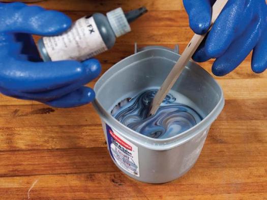

To adjust the colour of commercial pigmented or gel water-based stains, add dyes directly, stirring them thoroughly before use. The same goes for tinting water-based topcoats, which I’ve found need only two or three drops per litre to bring up the tone to mimic oil-based finishes.
