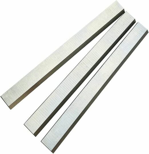

There are two basic types of cutterheads. The most most common, and least expensive is a cutterhead that uses straight knives (aka ‘blades’). Typically there are 3 to 4 knives on the cutterhead. Knife length is roughly the same as the width of the jointer table top – for example, a 6″ jointer will have 6″ or 6-1/8″ knives. The knives can be made of high speed steel (HSS) or more commonly carbide steel. Carbide steel will last appreciably longer than HSS before the knives need to be re-sharpened. Replacing straight knives on a jointer can be time consuming as the knives have to be adjusted so they are in-line with the outfeed table.
straight cutterhead knives
6″ carbide jointer knives.

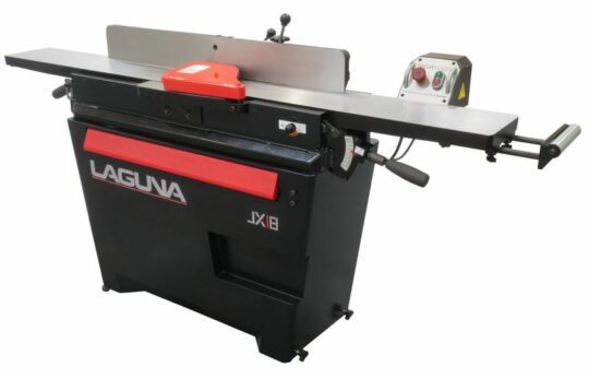

Laguna Tools lagunatools.com
Laguna JX8
    • 4 models
    • stationary
    • 6″ to 12″ bed widths
    • spiral cutterheads
    • $2,600 to $9,300

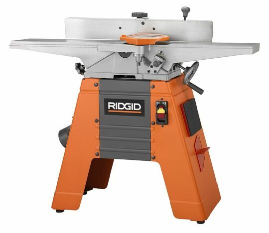

Ridgid  ridgid.com
ridgid jointer
    • 1 model
    • stationary
    • 6-1/8″ bed widths
    • Straight knife
    • $849.00

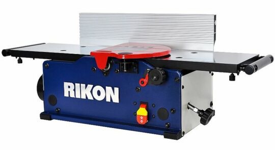

Rikon Tools  rikontools.com
Rikon jointer
    • 3 models
    • 1 benchtop; 1 stationary
    • Helical cutterheads
    • $655 to $5,000
