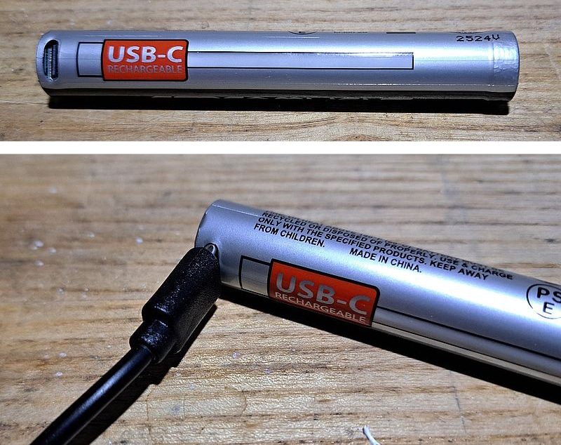

While you can use disposable AA batteries, it comes with a rechargeable 3.7V, 5.92Wh lithium-ion battery that delivers plenty of power — lasting up to 16 hours on the low setting. I find the low setting bright enough to illuminate work areas and the interiors of shop machinery. The light source is shock-resistant and rated for 50,000 hours of use.
The battery fully recharges in four hours. The charging system is built into the battery itself — just connect it to a USB cable and plug it into a computer or USB wall charger.

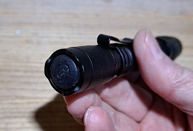

The flashlight is easily operated with one hand via the tail switch that you can activate with your thumb. Click once for high mode, twice for the strobe, and three times for low mode. It takes some practice to get used to this system, but once you do, it’s straightforward.

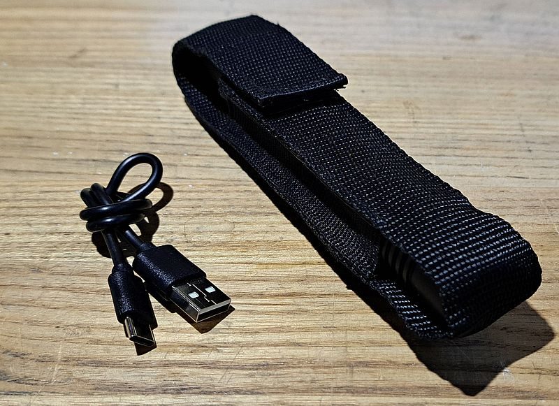

USB cable and carry case

Li-ion battery fully charges in 4 hours

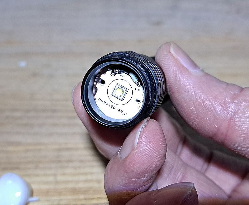

Long-life light source

Click button located on end of the light for easy manipulation by thumb
