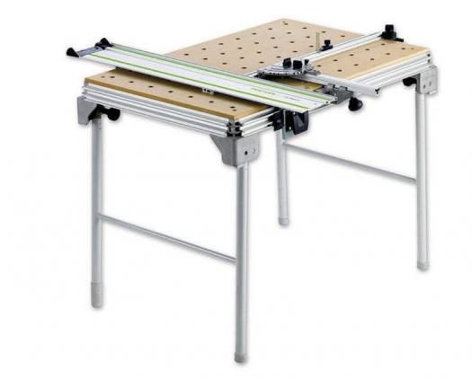

This new style of portable work table owes its genesis to the Festool MFT (Multi Function Table). These work tables consist of clamping tables – replaceable work surfaces (except for the Veritas) with a series of dog holes that can accommodate clamps and other hold-downs and fixtures to secure stock for you to saw, sand, rout and otherwise manipulate. The Festool and Triton clamping tables have 20-mm dog holes and the table legs fold for easy transit and storage; the Veritas has 3/4″ dog holes. T-slots on the top or side table rails provide extra clamping options.
The MFT/3 (#500608) is primarily (but not exclusively) designed to be used with a Festool track saw, a router or jigsaw (both require optional rail attachments), and a guide rail. The replaceable 19-mm MDF top is 33″ by 45″ and is encased in an aluminum frame with slots on the sides to mount various clamping accessories. There is a kitted version (#495315) for $968 that includes a 42″ guide rail, angle stop and hose/cord deflector.

Festool MFT/3 Basic, $812
One Serious Work Table – Festool has done a great job integrating their MFT/3 to work with their wide selection of well-thought-out power tools.
Festool MFT
