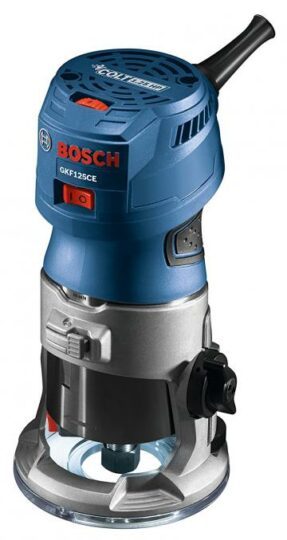

Still not sure if a full or mid-sized router is what you need? Then a palm, or trim router may be just the ticket for you. A palm router has several advantages over its larger sibling – it’s considerably lighter and smaller, so you can easily use it single handed; it’s size and weight also make it much safer to use than a full size router, particularly for those new to routing; palm routers are easier to manipulate when you need to do precision routing, such as for string inlaying, or shaping tight corners; and, for tasks like trimming edge banding, plowing narrow grooves and routing out hinge mortises, they beat the pants off the larger routers. Even better, a top of the line palm router costs about half the price of a top of the line full size router, while ¼” bits are less expensive then ½” bits. For just about any job that requires a bit up to 1 ¼” diameter and where the depth of cut will be 1″ or under, I use a palm router. Taking multiple shallow passes is the best, and safest way, to make deep cuts. You’ll get the cleanest cuts.
The Bosch Colt palm router (PR20EVS) has a number of features that earn it a ‘best of class’ rating. Adjusting bit height is a breeze. For quick height adjustments simply flick a quick clamp lever, and twist the motor housing, lowering or raising it the desired amount. You can make micro fine depth adjustments by turning a knurled wheel on the back of the base. A full turn of the wheel moves the bit 3⁄64″, a ⅛ turn moves it a mere .006″. One wrench bit change is great, and soft start means no jerking around when you turn it on. Its ‘constant response’ circuitry delivers consistent speed under load, which makes for smoother cuts, and the 1 hp (5.7 amp) motor delivers ample power. It’s not as noisy as the larger routers, and has very little vibration, even at full speed. I also found it to be the most comfortable (and hence most manageable) palm router that I’ve used. It comes with a good quality fence, wrench and storage case. Best of all, this router sells for just $174.99. We’ll be posting a full review of the PR20EVS on the new “Product Reviews” section of our web site this spring.
bosch colt router
