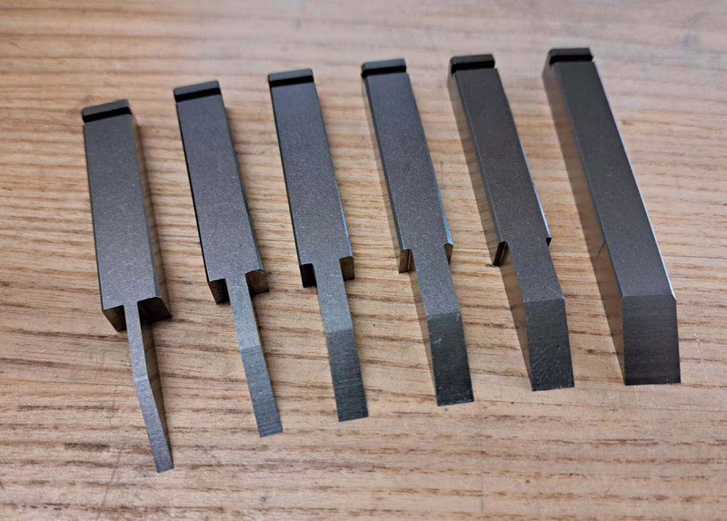

Blade Options – Although the plane comes with one 1/2” wide blade, you can get a set of either metric or Imperial blades to suit your needs.

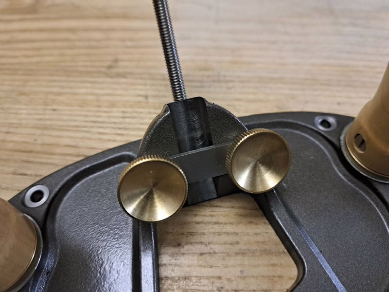

The plane body is made of steel and has a 50° bed angle. The knurled knobs are brass and the blades are made from a single bil­let of M2 high-speed steel. A tungsten-molybdenum alloy, M2 is the industry standard because it has good wear and abrasion resis­tance, is easy to sharpen and has a Rockwell hardness between 60 and 65 that’s “tough enough.” The blades are ground to a 30° bevel and can be put straight to use (unless, of course, you’re a perfectionist).

To do its job well the sole needs to be perfectly flat, and the MTC-11084 is spot-on in this regard. As well, the blade needs to sit perfectly flat in relation to the sole. In my tests the bevel edge of all the blades aligned perfectly with the sole. I really like the design of these blades. Unlike other router plane blades, which have the end of the blade oriented 90° to the arm, these MTC blades are easily sharpened.
Adjusting the cutting depth of the blade is straightforward. There’s a locking depth stop you use to set your target depth-of-cut. You then use the depth adjustment knob to set the cutting depth, working in small incremental steps to reach the target depth. Two clamping knobs hold the blade firmly in place once you’ve estab­lished your cutting depth – each time you adjust the cutting depth you need to loosen these knobs. The depth adjustment knob is fixed to an M6 × 1mm threaded rod. One full turn of the knob advances the blade 1mm. Because of the 50° bed angle this translates to a 0.77mm (.03″) depth-of-cut – near enough to 1/32″.

Melbourne router plane
Staying Put – Dual clamping knobs ensure the blade stays exactly where you set it.
