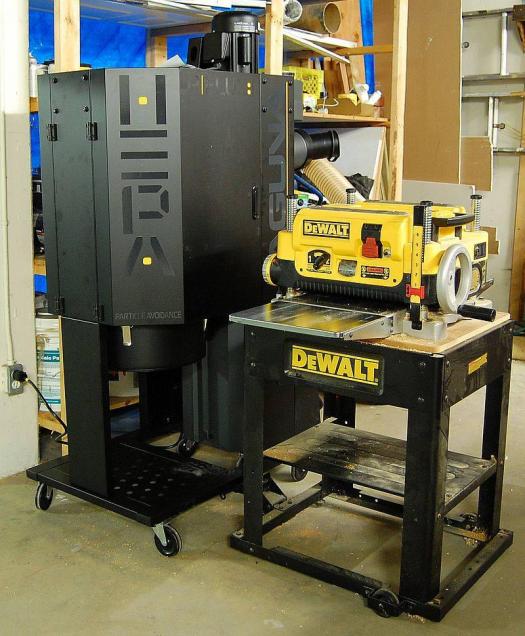

Theodore Roosevelt is quoted as saying that ‘nothing worth having was ever achieved without effort’. That goes for the P|Flux. Be prepared to spend upwards of 4 to 5 hours unpacking and assembling the collector – longer if you’ve never assembled a large machine before. Most of the work can be done by a single person, but you’ll definitely need a helper to lift the funnel/motor assembly onto the base. There are a lot of parts, so it’s best to read through the instruction manual before starting to assemble the P|Flux.
You won’t find much in the way of plastic on this machine – it’s primarily steel (including the impeller fan) so can easily put up with any errant bumps and knocks. I expect that the only two things I might ever have to replace on this machine are the motor and the control panel switch – after a decade or so of heavy use. Otherwise it looks built to last a lifetime.
One caveat though – all four wheels on the bottom of the dust collector are free-rolling. I would have liked to see two locking wheels. During assembly locking wheels would have helped to keep the unit from moving around. And, if your shop floor isn’t level, as mine is not, it would help stabilize the unit.
