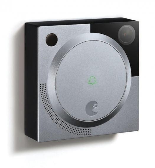

August.com
The August Doorbell Cam connects to an existing wired doorbell that has an analog chime. It’s not compatible with digital chimes. Your router needs to be within 10–15′ of the device, otherwise you’ll need to purchase a wifi extender. It works with the August Smart Lock. Features include a 720p low-light (not night vision) camera, motion detection, video recording and two-way audio. Comes in four colours. Android and iOS compatible.
August Doorbell Cam
