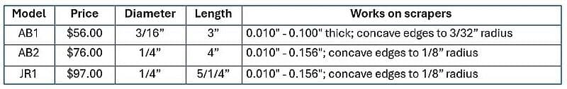

  • Manufactured from ground carbide.
  • Available as unhandled 3″ and 4″ rods and 5-1/4″ brass handled rod.
  • Enables you to produce a 5, 10 or 15 degree burr.
  • Works with scrapers that have widths from 0.010″ up to 0.100″

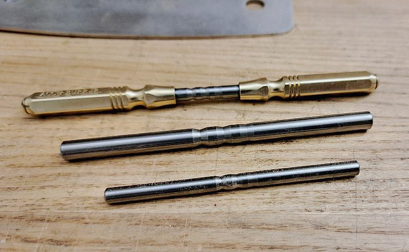

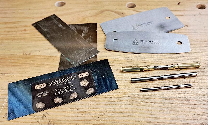

The AB1 and AB2 rods come unhandled — you can use them as is or add your own custom handles. Use the AB1 for card scrapers up to .100″ thick. For thicker scrapers, such as those found on cabinet scrapers, use the AB2. The JR1 burnisher is the AB1 rod fitted with a pair of beautifully turned brass handles.
These rods are made from ground carbide, which makes them stronger than steel but also more brittle, so be careful not to drop them on a concrete shop floor.

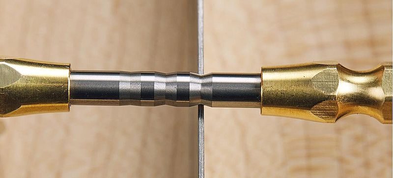

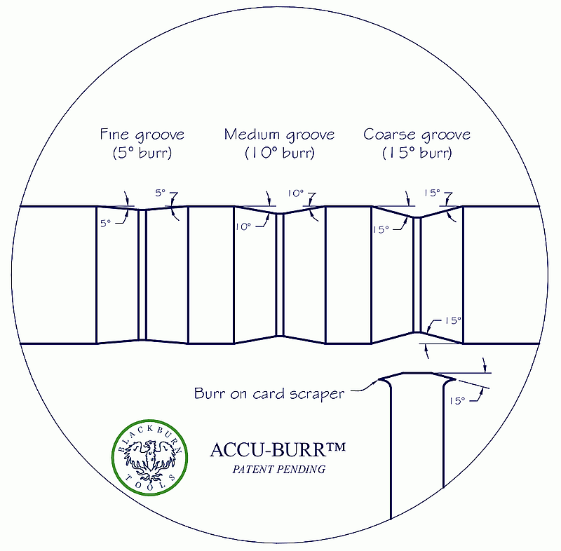

What sets these burnishers apart is their three precision-ground V-shaped grooves, each at a specific angle. This design allows you to roll a fine (5°), medium (10°), or coarse (15°) burr. The burr forms on both edges of the scraper at the same time. I typically roll a 5° burr on one side of a scraper, then flip it over and roll a 10° burr on the other, giving me four scraping edges with a choice between fine and medium burrs. I keep a second scraper prepared with medium and coarse burrs.
Using the Accu-Burr is simple. Secure your scraper in a vise, select the groove for the burr size you want, and draw the rod forward or backward across the scraper’s edge. That’s it. Apply moderate downward pressure and let the burnisher do the work—two or three passes are enough to create the burr. Check for the burr by running your fingernail along the scraper’s edge. The Accu-Burr works on all scraper shapes, including rectangular, oval, concave, and convex.
