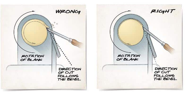

Rub the Bevel
Always rub the bevel when using a gouge or a skew. The bevel of the tool does two things. First, it directs the cut. If the bevel is pointing toward the center of the work piece, that’s were the chisel is going to go. It will try to follow the bevel straight into the center of the work. That’s how you get those nasty catches. If you imagine a line extending from the bevel, passing through the outside 1/16″ of the work, that’s the path the chisel will follow. This produces a 1/16″ deep cut. The bevel rubbing behind the cut prevents the chisel from going deeper into the work. No more catches. Secondly, the bevel supports the grain behind the cut so there is less tearout. As the edge of the tool cuts, the bevel holds the fibers in place behind the cut (much like the mouth of a hand-plane holds the fibers down to prevent tearing the grain). It is this action that determines the height of the toolrest. The toolrest should be set so you can cut in this manner and have the chisel handle in a comfortable position. With the toolrest too low, the handle is too low to be comfortable. It’s the same when the toolrest is too high.
