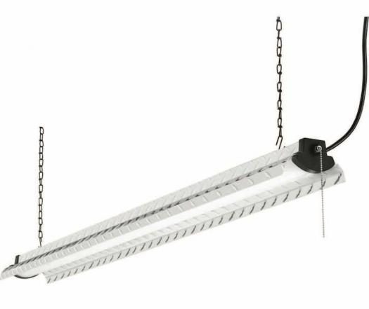

Lithonia Chrome Diamond Plate Linkable Fixture, $59.99
Available from Home Hardware, this fixture enables you to connect up to 10 fixtures using a single power cord. The tube has a 4000K colour temperature with a CRI (colour rendering index) of 80 and consumes 40W. (Photo by Lithonia)
ceiling shop light fixture

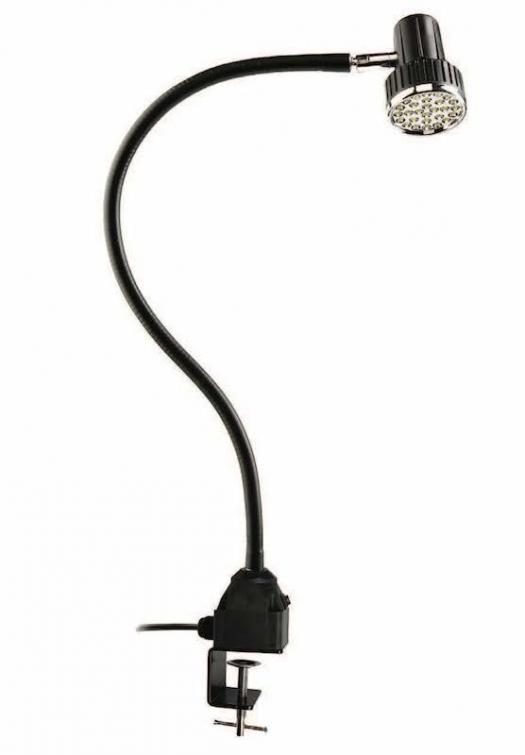

The ubiquitous swing-arm and flexible neck clamp-on lamps are popular because they’re inexpensive, can be easily attached to most work surfaces and the light can be positioned to focus right where it’s needed.
UberLight 3000TL, $102.70
ReliableCorporation.ca
This high-quality AC-powered fixture has a clamping capacity of 1-3/4″ and its 26″ flexible metal arm keeps the lamp head firmly in place. The 28 surface mounted LED diodes have a 5700 to 6500K colour temperature and you can switch between 200 or 500 lumens of light output. A honeycomb lens cover reduces glare. (Photo by Reliable Corporation)

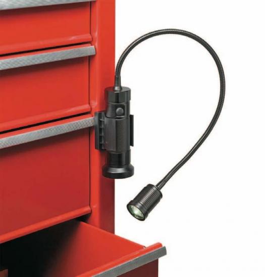

Magnetic-Mount Work Light, 15J7701, $39.50
LeeValley.com
As either an alternative or supplement to a flexible clamp-on lamp this light has an 18″ flexible neck with a rare-earth magnet base enabling you to attach it to any metal surface. There are optional 3/4″ (#15J7704) and 20-mm (#15J7705) dog hole posts ($4 each) so you can mount the light on a workbench. It uses three AA batteries for up to 5 hours of continuous operation. (Photo by Lee Valley)

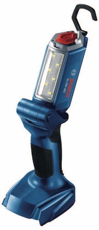

Bosch GLI18V-300N, $67.90
BoschTools.com
300 lumens. 160° articulating head and hanging hook. 1-year warranty. Also available as a 12V model (GLI12V-300N). (Photo by Bosch)
Bosch GLI18V-300N

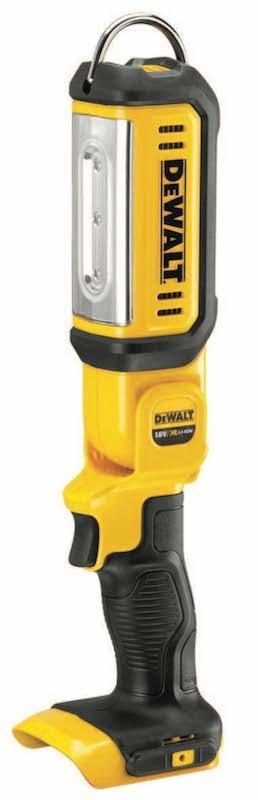

DeWALT DCL050, $69.00
DeWalt.ca
250 and 500 lumens. 140° articulating head, 360° rotating hanging hook, and belt hook. Also available is a 110-lumen model (DCL040). 3-year warranty. (Photo by DeWalt)

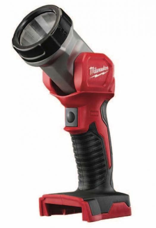

Milwaukee 2735-20, $82.95
MilwaukeeTool.ca
160 lumens. Aluminum head rotates 135°. Hanging hook. Seven other 12V and 18V styles available. 5-year warranty. (Photo by Milwaukee)

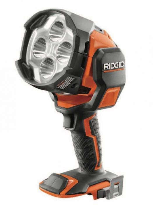

Ridgid R8694220B, $109
Ridgid.com
Up to 2,500 lumens. Lumen output adjustable over 18 levels. 180° articulating head, 1/4″- 20 thread mount, belt clip, and 12′ 12V vehicle adapter with integrated cord retainer. 5-year warranty. (Photo by Ridgid)
Ridgid R8694220B

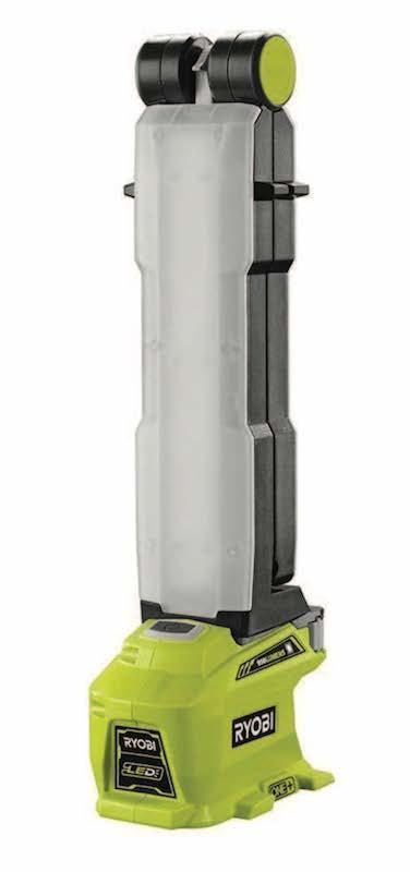

Ryobi P727, $69.98
RyobiTools.com
950 lumens. 2 banks of LED diodes, one bank rotates 270°. Mounting hook. Also available is an AC/DC model (P790). 3-year warranty. (Photo by Ryobi)
Ryobi P727

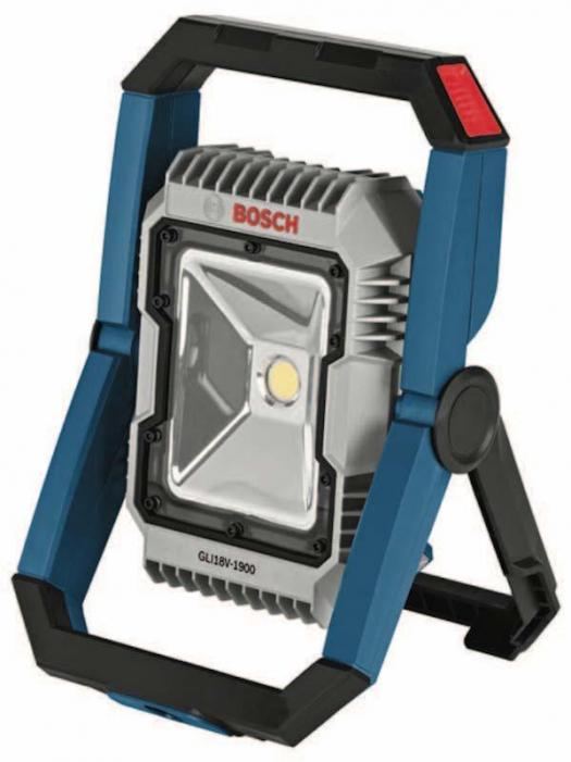

Bosch GLI18V-1900N, $99 (bare tool)
BoschTools.com
1,900 lumens. Single LED diode. 120° articulating aluminum head, 5/8″- 11 thread mount. Also available is a 420-lumen model (GLI18V-420B) and 12V light (FL12). 1-year warranty. (Photo by Bosch)

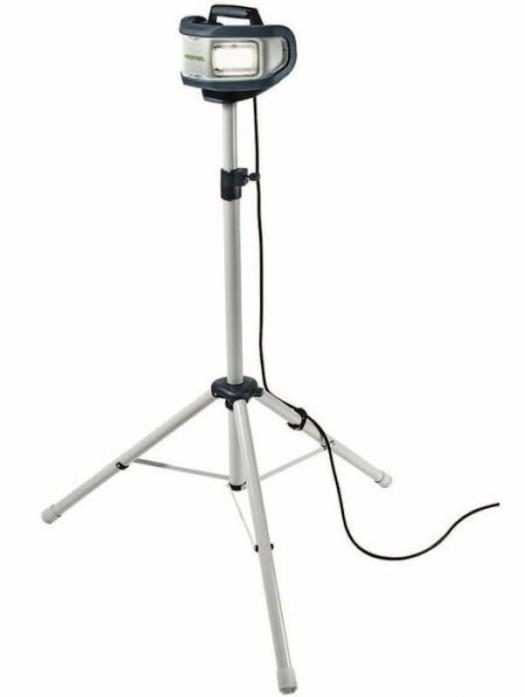

Festool (2 models)
FestoolCanada.com
Both of these lights have a 5,000K colour temperature. (Photos by Festool)
Model DUO-Plus KAL II
Price $425 $280
Lumens 8,000 310 and 769
Other AC,
180° light diffusion,
IP55 rating
Internal 7.2V 2.9Ah battery,
4.8 hrs on low setting, 2 hrs on high setting,
3.3-hr recharge time,
Hanging hook
Available with bench stand (KAL II SET, $355)
festool KAL

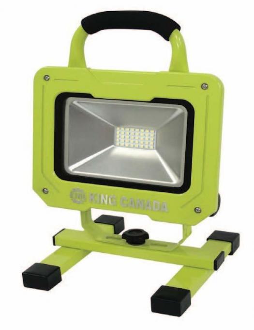

KC-2202LED-C $69.99
KingCanada.com
Has 2,200 lumens with high/low settings. Comes with integrated 4.40Ah rechargeable (5-hour) battery and AC adapter. Magnetic base. 2-year warranty. (Photo by King)

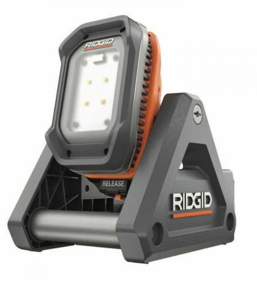

Ridgid R8694221B $129 (tool only)
Ridgid.com
Variable brightness up to 2,500 lumens. Two folding panels and a center panel. Optional AC extension available. 1/4″-20 thread mount. Also available in a 1,200-lumen model (R8694620B). 3-year warranty. (Photo by Ridgid)
ridgid R8694221B

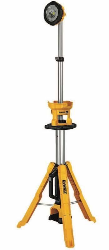

DeWALT DCL079R1, $469
DeWalt.ca
Three light settings from 1,000 to 5,000 lumens. Includes 20V 6Ah battery and charger. 39″ collapsed, 84″ extended. Carry handle. Shroud protects light head. 3-year warranty. Also available as a bare tool (DCL079B) for $299.
dewalt DCL079R1

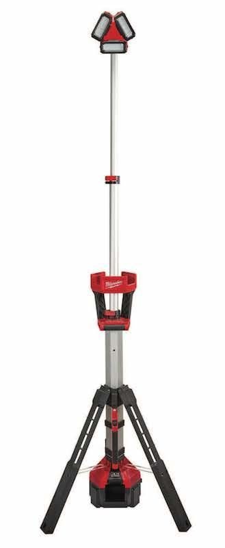

Milwaukee Rocket (3 models)
MilwaukeeTool.ca
There are 3 models in the Rocket line. All feature a 4000K colour temperature and a CRI of 85. Sold as bare tools. 5-year warranty. (Photo by Milwaukee)
Model 2120 2130 2135
Price $999 $329 $498
Lumens 1,600 – 5,400 850 – 2,000 900 – 3,000
Other Single or double 18V,
22″ collapsed, 65″ extended,
Rotating head,
IP54
ONE-KEY
40″ collapsed, 84″ extended,
Rotating & pivoting head,
Low battery indictor
18V or AC
41.5″ collapsed, 84″ extended,
3 independently pivoting light heads,
Built-in charger
milwaukee rocket

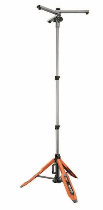

Ridgid R9937B, $69.98
Ridgid.com
This tripod stand is sold without a light. You can mount up to 3 lights that have a 1/4″- 20 thread.
30″ collapsed, 84″ extended. Carry handle. 3-year warranty. (Photo by Ridgid)
