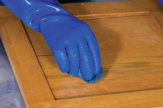

Pick a small inconspicuous spot to try different solvents.
Detailed cleaning
 Use turpentine and a rag or steel wool to remove any grunge or wax build-up on the surface.

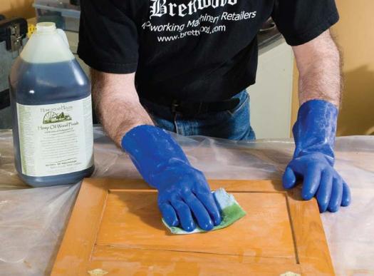

 In the case of an oil finish, apply more oil to the surface to rejuvenate the finish.

You will need to know what fam­ily of finish your piece is before it can be revived, and that takes only a simple solvent test. Because you’ll be play­ing around with some chemicals, have your eye wash bottle close at hand, wear clothing and shoes you don’t mind get­ting solvent on, then don your safety eye glasses (preferably chemical splash goggles) and neoprene gloves. Locate an area to work in that is well venti­lated and well lit, then place a plastic drop cloth down and turn the piece over there onto its back. Select a small, 2″ square area that’s as inconspicuous as possible and clean that area with a rag lightly soaked in turpentine. Now that it’s clean, take a good look at the test area. If you can see open pores of wood under the finish and the finish is not glossy, odds are that an oil and wax fin­ish has been applied. If that’s not the case, test for shellac. Take a fresh rag, soak it in denatured alcohol and wring out the excess before rubbing the test area gently. If the finish starts to dissolve right away or becomes sticky and dark­ens the rag, the finish is indeed shellac. If that doesn’t do anything to the finish, clean the test area again with turpentine and, once dry, start your test for lacquer. Do the same as before, only this time use lacquer thinner. If the finish comes off, it was likely lacquer. If nothing so far has affected the finish, it’s most likely a modern, vanish-based finish. Congratulations, you’ve identified the family of finish you’re dealing with, and are ready to begin the revival process.

If the piece has been around for any number of years, its finish has likely been smothered in countless layers of built-up wax and polish that need to be removed. A turpentine-soaked rag you’ve wrung out is just the ticket. As you did in the initial cleaning, things go best if you proceed methodically, working on only one section at a time. Rub down the entire area with the rag, refreshing the turpentine whenever the old polish or wax appears to be smear­ing around rather than coming off. As each area comes clean, wipe it down with a fresh rag. Don’t be skimpy with your rags as they’re far less valuable than your time.

Regardless of the oil that was originally used, be it tung, teak, Danish, hemp, or whatever, any other oil may be applied success­fully. Thin the oil of your choice (I prefer hemp oil, incidentally) 50/50 with clean turpentine and apply it liberally with a rag or brush, one area at a time. Once it has become tacky, wipe off the excess with a clean rag and allow it to dry over­night. Using unthinned oil, apply as many additional coats as the wood will soak in, or until the desired effect has been achieved. Now proceed to Step 5.
