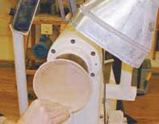

It is easy to find the 2hp dust collector but 6” flex hose is expensive and rather hard to find. So I developed a hood to fit a four inch flex line. A typical roughing out operation on a piece of green wood results in the long shavings being directed toward the operator. These shavings are typically harmless except in the case of toxic woods. When sanding a bowl there are a couple of important things to note about proper dust collection. First, the dust hood is positioned and oriented toward the bowl to maximize its effect. Secondly, the operator is keeping his hands in the 6 – 9 o’clock quadrant of the bowl, which is the safest position.

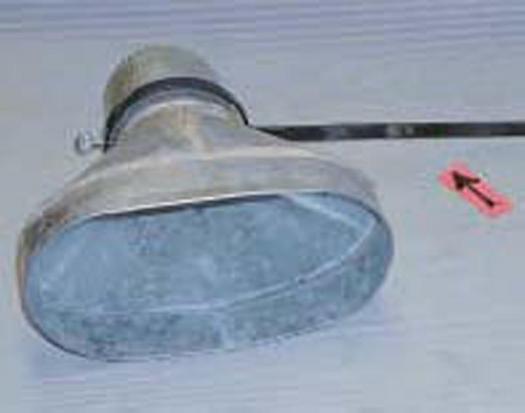

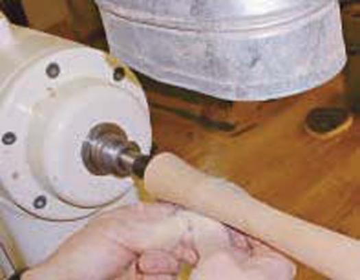

Notice the operator’s hand placement in this spindle sanding operation, with the hood oriented for pick up. This is a manufactured lathe hood. The arrow indicates the universal mounting bracket.

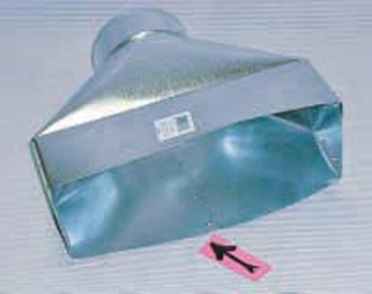

The bracket is bendable and can be bent as necessary and permanently fastened or clamped to the lathe. The “end boot” is an HVAC (heating, ventilating and air-conditioning) fitting that can be adapted to dust collection. You can fashion a bracket to hold it in place or you can permanently fasten this to your lathe. Be sure to fold the exposed edges over to eliminate the sharp edges indicated by the arrow.
