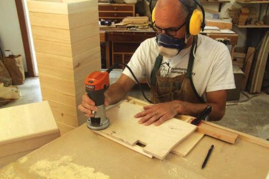

Good Jigs
The Baltic birch material Brown used for his jigs is flat and durable, leading to fewer inconsistencies down the road. Here he uses a notched jig to machine the 420 hinge mortises in the lid and main portion of the boxes. Notice the stop blocks positioning the workpiece and jig.

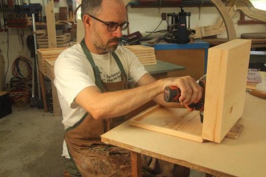

Simple Things, Big Rewards
Small things, like the spacer block the main portion of the box is resting on during hinge installation, pay off in huge ways when doing the same operation repeatedly. This spacer block positions the main portion of the box perpendicular to the work surface while the hinges are being installed.

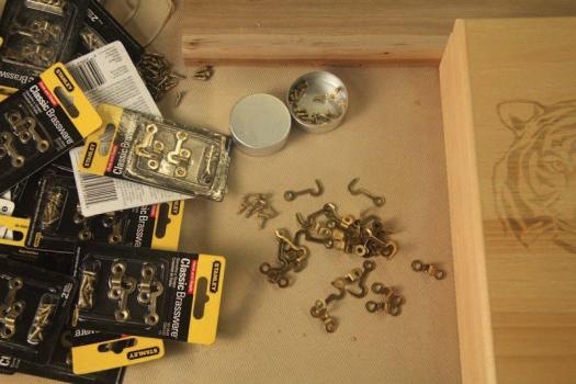

Consider Hardware
Before you start building, be sure to have enough hardware on hand for every piece you’re building. It could turn into a nightmare if hardware dimensions change even slightly, and you have to start re-working anything.
