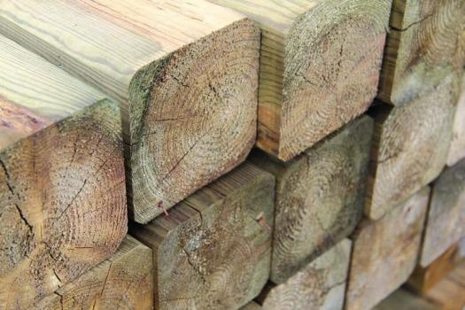

Reasonably Priced
Along with cedar, pressure treated lumber is a very common option for outdoor usage. It does have one large advantage over cedar though; it’s generally much cheaper.

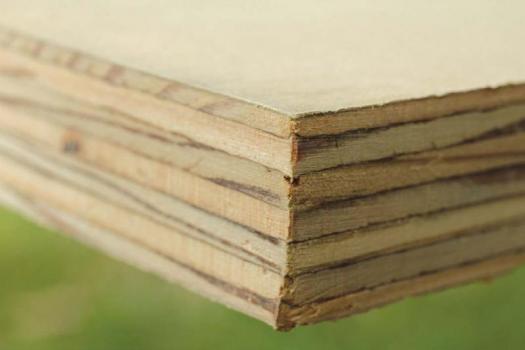

P.T. Ply
Like its solid wood cousin, pressure treated plywood is great for areas that might see some moisture, but aren’t visible. It comes in a number of thicknesses.

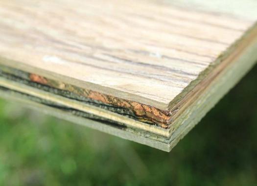

Signboard, Etc.
This piece of medium density overlay consists of one piece of 7-ply plywood sandwiched between two very thin layers of waterproof MDF. Some manufacturers produce MDO with MDF face and back layers of different thickness.

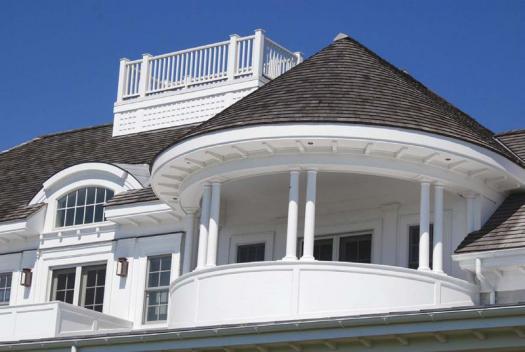

Maintenance-free
 Azek is available in many different trim options, so you can match the trim in your home to your deck. It will last for years without any maintenance whatsoever. (Photo by Azek)

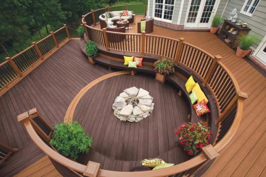

Composite Materials
Composites are made partially from wood and partially from a synthetic product. There are many companies that produce composite boards, and all are slightly different. (Photo by Trex Company)

Pressure-treated: This old standby, often the wood of choice for deck work, is softwood that has been chemically treated to resist rot and insect damage. While it is a functional and inexpensive choice for outdoor projects, many people are unaware that the pressure-treated lumber available today is much different than that of a decade ago and requires special treatment. Once treated with toxic chemicals such as arsenic, environmental concerns have resulted in a new breed of cop­per treated lumber. While less toxic than its predecessors, it is extremely hard on some metal fasteners, with stainless steel being the fastener of choice for longevity. Also, you’ll want to ensure that no aluminum comes in contact with this new pressure treated lumber, as it corrodes extremely quickly. For flashing and hardware, stick with painted steel.

Pressure-treated plywood: This is standard spruce ply­wood that has received the same chemical treatment as pressure-treated lumber to help it last as long as pos­sible outdoors. Available in 4×8 sheets and in common thicknesses, it’s an ideal choice for outdoor construction, especially for applications where it won’t be seen, such as shed floors.

MDO: Medium Density Overlay is a “sandwich” con­sisting of two thin sheets of waterproof MDF wrapped around a core of plywood. Originally developed for mak­ing outdoor signs, it works great for any application where you will be painting the final project.
Azek/PVC Sheeting. This stuff is the final word on longev­ity for any outdoor project. Available in thicknesses from 3/8″ to 1″ and in sizes up to 4′ x 20′. The material works very much like wood and can be routed or cut with standard woodworking tools. Like wood, it can be glued, screwed or nailed into place. And because it is 100 percent plastic, there is no wood fibre to rot, fade or discolour.
Plastic/composite decking.
I’ve noticed that regardless of what the decking is made from, if it isn’t solid wood many people call it “composite decking”. It’s important to understand, however, that composite is a very specific type of decking that is com­posed of plastics and wood fibre or sawdust, hence the term “composite”.  There are pure plastic and PVC selec­tions available as well, and the non-composites tend to be my choice for most projects, although in the past I have installed pretty much every type of manufactured decking.
Off the top of my head there’s polyethylene, polypropylene, PVC, hollow, solid, wrapped, etc., and to get into the pros and cons of each type would take an entire article in itself, so here we’ll just look at how you can use it.
Obviously decks come to mind, but I’ve found it generally works very well for pretty much any woodworking project where you would normally use 5/4 cedar or PT decking. I’ve used it for docks, utility trailer sides and decking, table tops, rural trash can boxes and even Muskoka chairs and benches.  The uses are pretty much endless, and there’s the added benefit of having your completed projects look as good in five years as they did the day you built them, and with virtually no maintenance.
