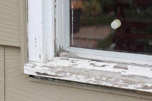

Rough and Worn
An old, weathered window not only looks awful, it allows water and cold air to enter your home. Sometimes it's just a matter of some fresh paint, but often it's a situation where replacing your windows is the only option.

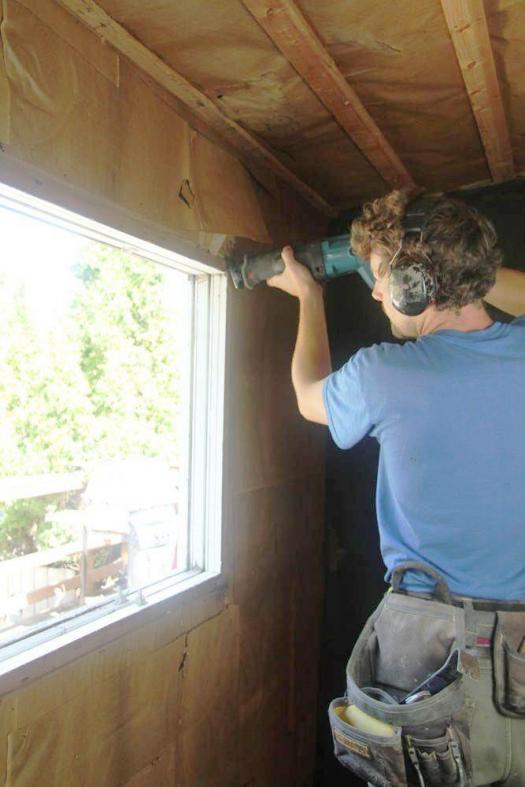

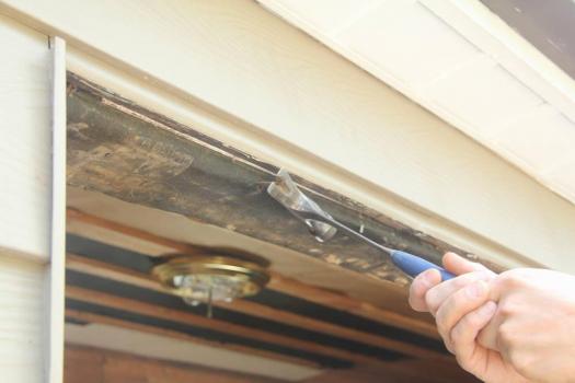

Get it Out
 Removing any screws, and using a reciprocating saw to cut through any nails, is a good place to start when it comes to removing a window.
Pesky Nails
 Ensure all nails and other debris that may cause the new window to not sit properly in the opening are removed. Now is also a good time to check for any rotten framing members, and replace them.

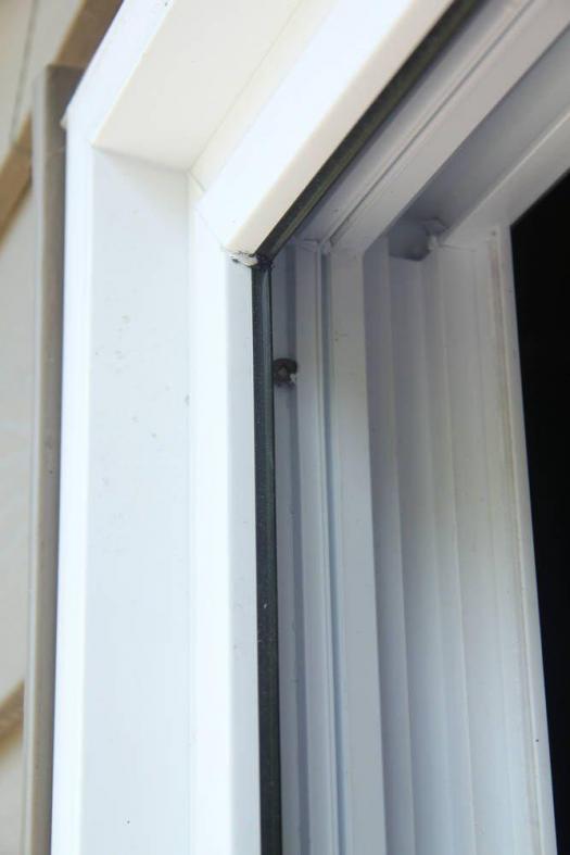

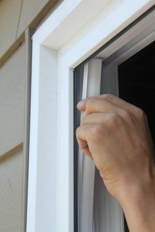

Remove a Strip
The new window very likely has a removeable strip of vinyl that can now come out (left). Screws can be driven behind this strip, then it can be put back into position to hide any screw heads (right).

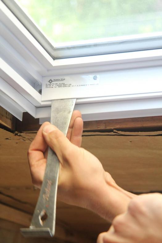

Another Removable Strip
 It may be possible to remove a wide strip across the lower section of the new window in order to hide a few screws behind it. If you're careful taking it off nobody will ever know it was ever removed.

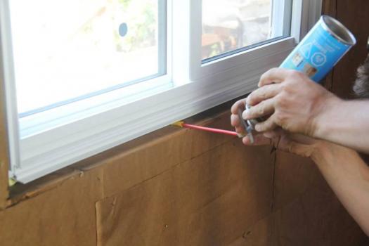

Add Some Foam
 Proper window foam will go a long way to keeping cold air out, and will also assist with keeping the window positioned where it is. Once cured, it's surprisingly strong.

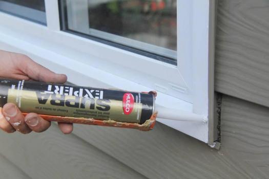

First Line of Defense
 A quality exterior-grade caulking will last a long time, and is the first line of defense in keeping the elements out of your home.
Out with the old
Once the new windows arrived, it was time for demolition. There are several types of windows out there, so different amounts and methods of demolition may be required depending on what you are starting with and how the new window is being finished. In our case, the entire window frame needed to be removed so we would have a large enough rough opening.
First, the individual panes of glass were removed (as is the style of older Pearson-style sliding windows). Next, the wood frame was removed by using a reciprocating saw to cut the nails between the window frame and the rough opening framing. Note that in some cases it may be possible to simply back out the screws that hold the window frame in place, but being an older window, our frame was fastened in with hand nails. It may also be necessary to cut the window frame itself in one or more spots with a reciprocating saw to be able to remove one side of the frame at a time.
When all of the necessary wood and nails were removed, the rough opening was thoroughly cleaned with a shop vac along all sides.

Expanding foam
At this point, it’s appropriate to apply expanding foam around the outside of the window. I generally like to foam across the bottom first, then both sides, and the top last. Use window and door approved spray foam. Other types of expanding foam, such as big gap/crack filler, can expand too much and bend the window frame. Close and lock the window before applying any foam and leave the window this way until the foam is fully cured. When foaming, hold the nozzle close the brick mould, if there is enough room for it, so the foam expands all the way to the brick mould and you do not trap pockets of air.
The last detail of the installation to perform on the inside is to cut the shims and cured foam back flush with the window frame. The foam normally cures in a couple of hours, but sometimes it’s necessary to leave it overnight. If it’s still a little tacky when you try to cut it, just wait a little longer. There is no need to rush it and your knife blade will thank you.

For completing the installation on the outside, it was simply necessary to apply a high quality caulking between the brick mould and the existing J-trim of the exterior siding. For this project, the type of caulking used was Supra by Mulco, which is available in a large assortment of colours.
